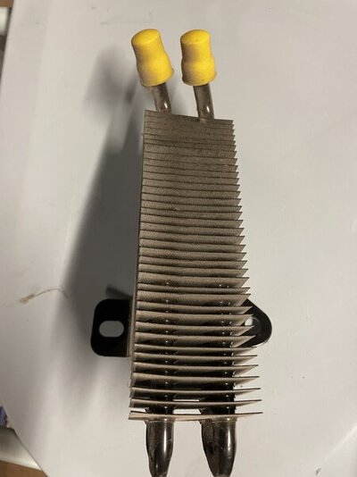

I am adding a 65 C Body cooler to my 65 Dart. Steer and Gear rebuilt my steering box to their Stage III (modern day feel) specs, i had the cooler so I figured why not use it. Unlike an OEM cooler for your application, mine is all custom. I might have a factory cooler that is a bolt-on to your PS pump. I’ll see if i can locate it and send you a pic

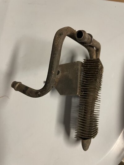

Here is a PS cooler that came off a SB Cop car
Even some 2nd Gen V8/V6 Dakotas got them. One that will eventually be installed on my 93
And certain 65-earlier c Bodies and Imperials had them but never an early A
