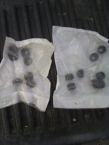

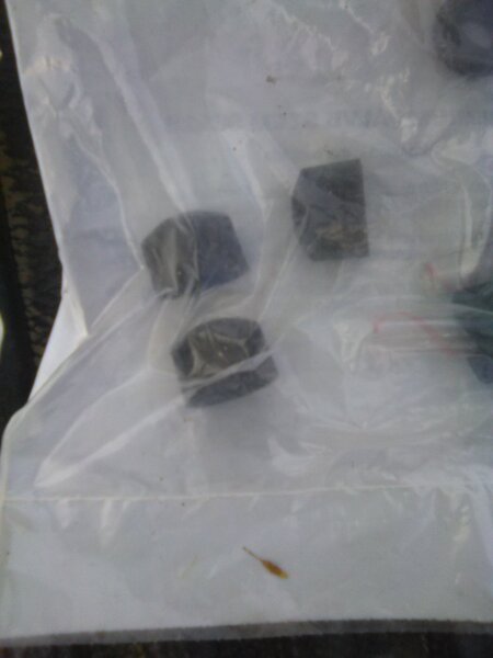

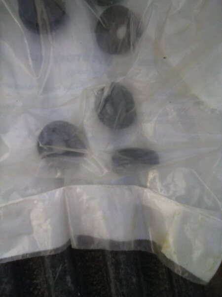

The two packs of seals in my Felpro box have one set of small black seals (foto #2) and one pack of larger/thicker black seals (foto #3). Anyone know which are intake and which are exhaust? I find it strange the packaging does not define them one or the other.
And why are they different anyway? Thank you.

And to answer your question,,,,the smaller ones go on the exhaust,,,,,since the gases are flowing up,,,,,the seal doesn’t have as much to guard against.
