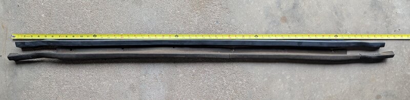

It came in a box 1/2 its length but being soft rubber the seal had no trouble flattening out in the sun for 15 minutes
The shape and hole cutouts are spot on and the fit and feel is wonderful.

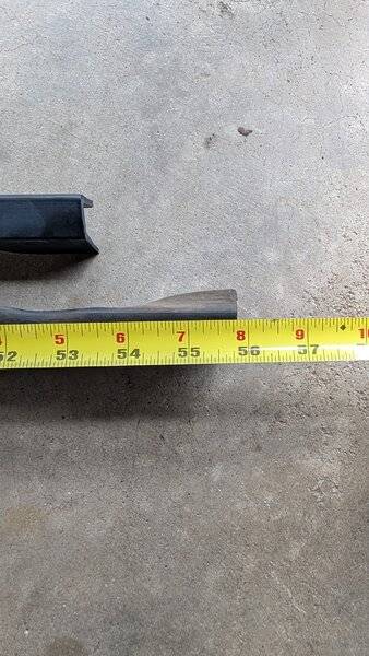

Length is about 2 1/2" short but I don't see that causing any issues
DMT
OEM
The profile is dead on!
I could not get a good photo so you will have to trust me on it.
The OEM seal came off in 3 pieces so it fit well in the shipping box :rolleyes:

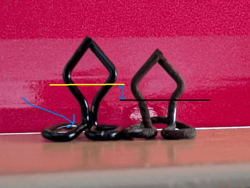

I got it installed in under 5 minutes, but I notices that it did not sit tight against the hood, it has wiggle room!
I looked at the OEM clips and the supplied replacement clips and that's where the issue is. The yellow line is where the clip is the same width as the OEM clip and you can see on the OEM clip a wear mark where it sat in the hole in the hood.
I tested this by replacing one of the new clips with a OEM clip and it was nicely snug.

And for bending the clip... I as the consumer should not have to modify a product for it to fit correctly. The OEM clip is wider where the 2 wires turn up and widening that makes the part where they cross wider. Also the shear height of the diamond is higher.

That being said even with it loose it will function as intended. Only downside I can see is the loose clip might wear paint off the holes in the hood as it moves around.
I don't know. The tag on the bag doesn't say.
