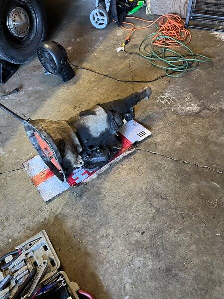

Traded the 2.76 3rd member for this today. I’ve got some 3.73 gears for an 8 1/4 now I just need a sure grip and an install kit. Gonna run it until it breaks then upgrade. Should be half the price of modding the Newport 8 3/4. Yeah I picked it up in my Sentra.

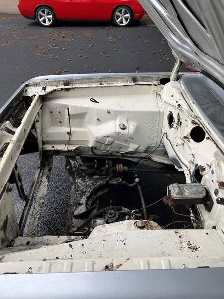

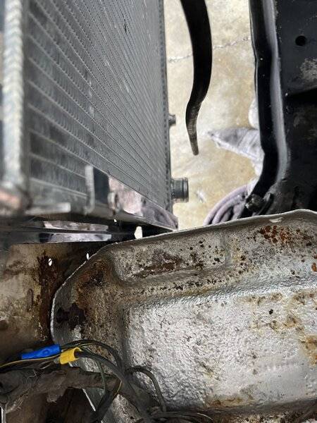

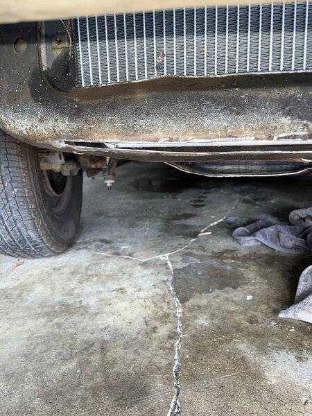

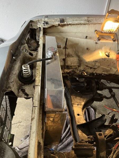

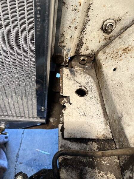

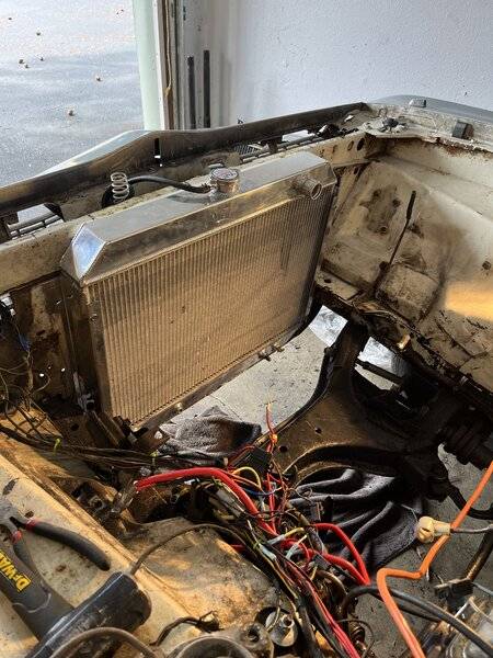

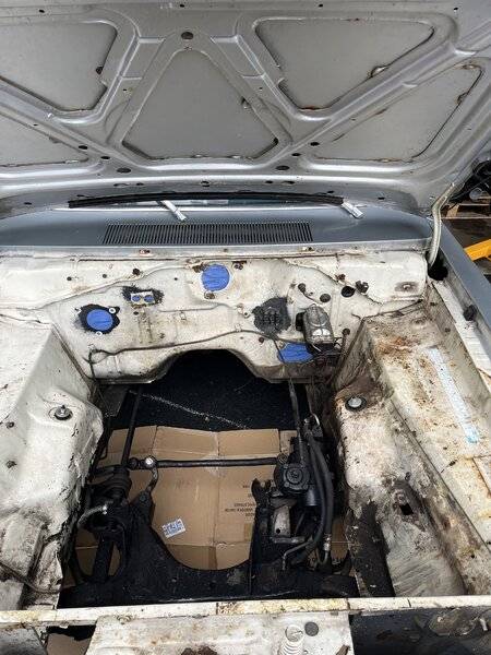

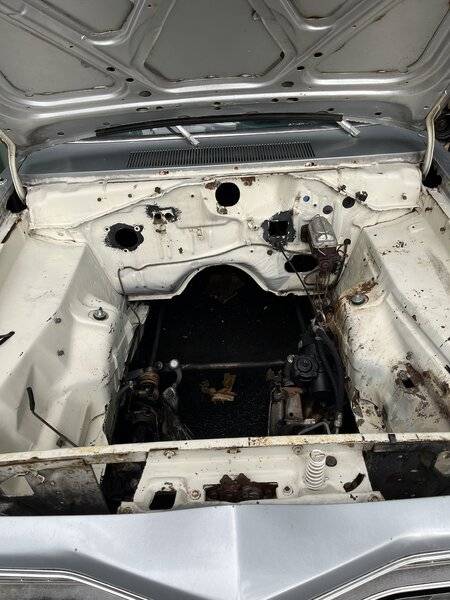

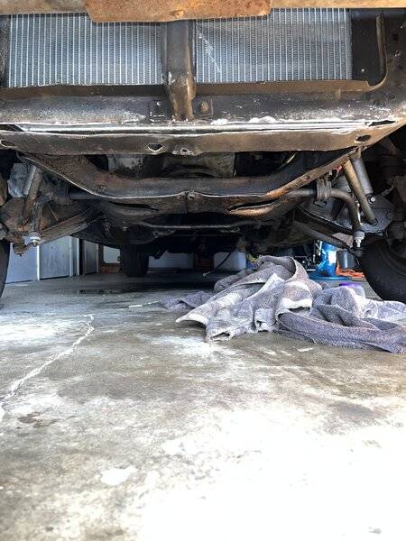

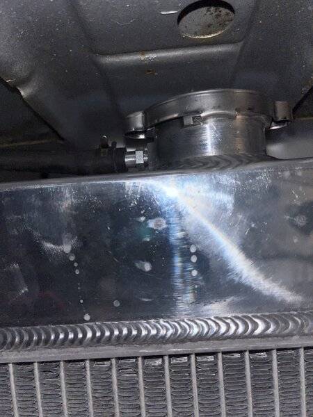

Time to make the radiator fit. Rather than cutting the bottom of the support out completely, I am cutting a channel out of the rad support that will run the length of the radiator. Essentially removing the rounded bend in the support, turning it into a true 90*. Once the rad is bolted in I think I am going to get some 2x2” aluminum angle to cover the slot and add some rigidity back to the rad support.

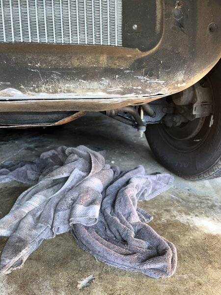

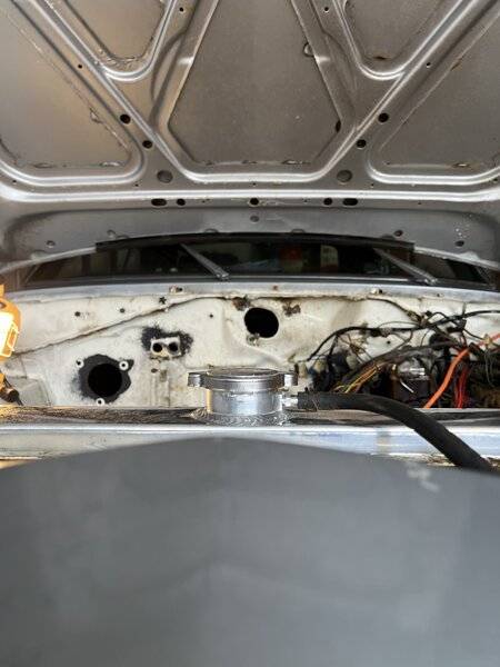

It’s bolted in and clears everything. This was a lot of work, but I feel like it was worth it. Not only did I not have to buy another radiator, but I was able to stuff just about as big of a Mopar style Radiator as I can in there. my idea pretty much worked out. I still need to bend the bottom portion, where it touches the corners of the radiator as you can see in the pictures. Once it’s bent out flat it should have plenty of clearance. I also think it will be pretty easy to patch up with either a piece of aluminum, or this pretty trick radiator support brace that I’m seeing around town.

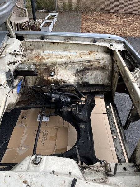

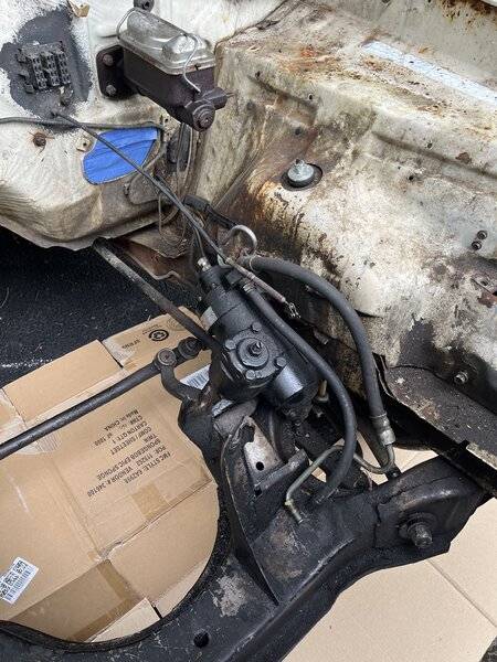

I have to swap to manual steering, that’s ok I was going to do it anyway. I will also have to trial fit them which means pulling the motor hopefully less than 10 times and using a ball peen with surgical precision.

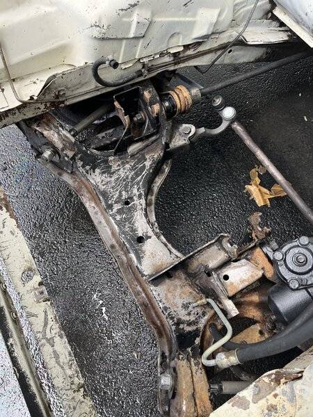

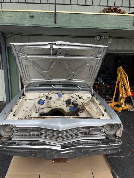

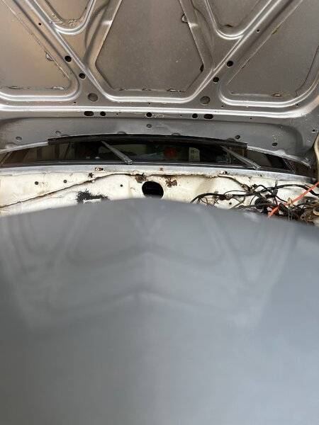

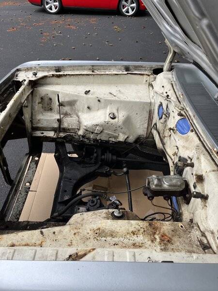

After, this was a lot of that shitty work no one likes, and I’m still not satisfied. I’m going to clean it again before cutting and painting the K member.
I’m still undecided if I will actually paint the engine bay or not. I’ve got baby number 3 due in march and I feel like I might need to change plans just to get the motor in. I may go for the ratty muscle look, just clean everything up really good and leave the patina. I really want to drive this thing before I’m an old man…
I always dig cars that come together like this. Looking forward to seeing the engine in it!

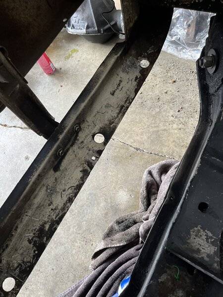

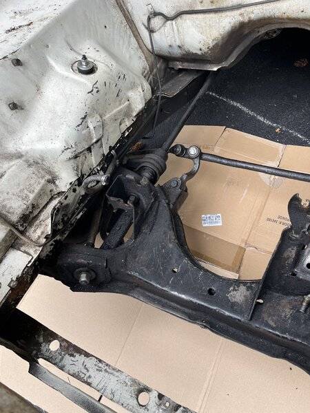

Me too man! It can get a little overwhelming at times, but I just tackle one project at a time. Today I will be modifying the K frame as per the Schumacher instructions. If I get some time I’m going to test fit the drivers side header for the header to starter clearance. Might as well start the header fitting now, hopefully I get lucky.

Mod K frame for BB clearance

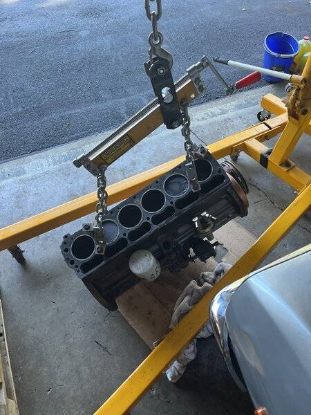

Swap motor/trans in

That was about how my list looked (looks) I also went from power to manual steering.. what adapter are you going to use?

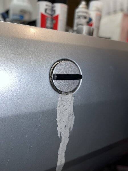

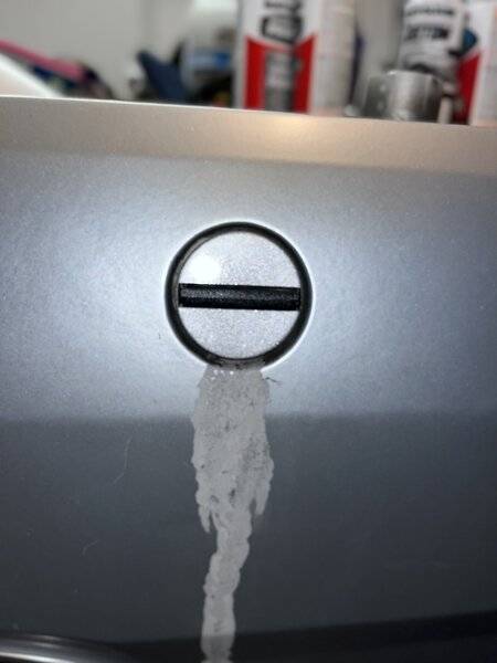

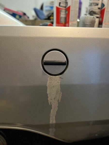

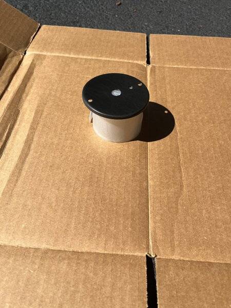

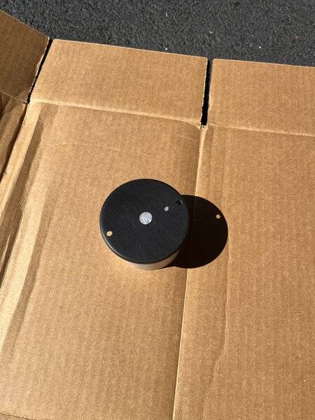

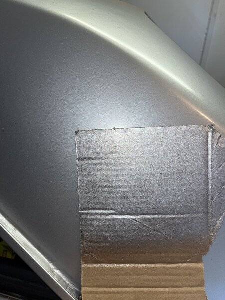

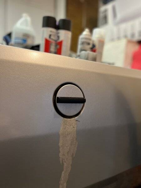

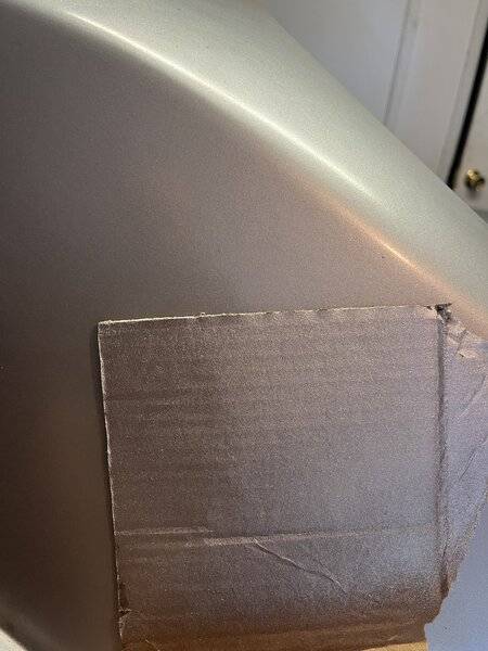

Test spray on some cardboard and the cheapo gas cap. It’s definitely more metallic than the body, but with the dark primer the color is pretty close. Will top coat with a gloss to help with durability.
Not too bad for a $5 gas cap and some spray paint. I’m very happy with how close the match is. As I have stated before, it’s a significantly different amount of flake but the color is “close ‘nuff!” I think I might try to fix the gas stain with this paint. Pics with flash and without.
