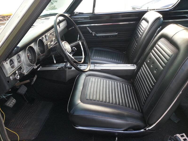

Did you cover those yourself?
I did with assistance. My car in magazine

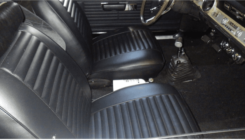

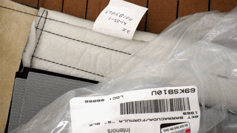

My covers were manufactured in 2014.
Here's what they look like this morning..........
