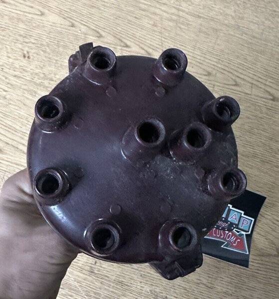

This is on the original 273 prestolite dual point for my 65 dart.
