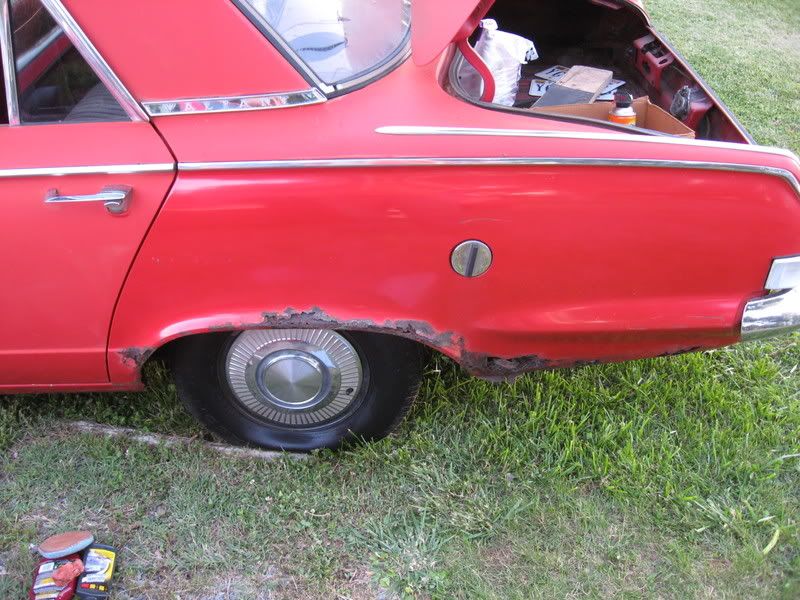

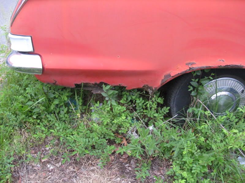

I know we won't be doing anything soon body wise on the car but I'd like to know where I stand with parts in advance. I'm working on restoring this little Valiant for a fun summer cruiser and possible replacement car for my girlfriend when her Neon eventually dies.
So does anyone make patch panels for this thing or is it going to be a homebrew situation?
I had heard/read something about Laysons maybe having them but I'm unsure, I've also heard some not great things about laysons too....
And being that a picture says a 1000 words....
Thanks in advance for the help guys
The patches from Layson's will do the outside fine. Get a hold of Rick Keesler at Layson's personally. [email protected] He will see you get your panels in good order. The inside, aka "trunk extensions" will be a liittle harder to do. I think you have to modify 2nd gen Dart/Barracuda ones to fit the earlier bodies. Ask Rick to make sure.
