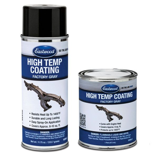

Eastwood Factory Gray is my go to for exh manifolds.
They have a brush on, or spray.
