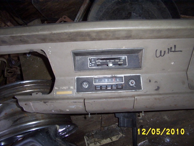

I still want to fix my vent controls, but I don't know where to start. Can anyone tell me how they work? Are they vacuum controlled, or cable-controlled? Are there common issues related to this problem?
Here is a pic of the kind of controls I have. I pulled it from the classifieds, but it's identical to my setup.
attachment.php
Air direction is vacuum controlled. The WARMER slide is a cable operated door. Here's a tip... lack of vacuum results in default door position ( defrost ). Without the vacuum reservoir the air direction would switch to defrost under hard throttle. That's why it's needed. Hope this helps
You wouldn't happen to have a vacuum diagram, would you? It's okay if you don't. Now that I know what I'm looking for, I can start to diagnose it.
