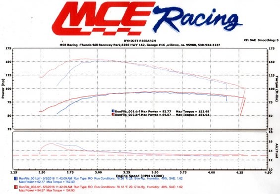

We brought in a mobile dyno today. I ran the Dart. What do you guys think? It put up better numbers than I thought it would.
It seems to be automatically resizing them. The gist of it is 94 hp & 154 ftlbs
I'd like to say wow! As in Great!
Alas, I'm small block guy......and .418 hp/cid, well...............
On the flipside it makes pretty good torque. I guess that's what a 4.125 stroke will do,eh
Stone stock ? any mods ? if not and it's a 50 year old engine,,that's good at the rear wheels. And yes Slants are known for their torque.Again if it's stock I'd be happy.
Funny....the 225 feelslike it has more grunt for even the torque it makes. It hasn't once left me feeling like it was severely underpowered when i dd it.
PowernationTV did a "hop-up" on a slanty, and it baselined at 70hp or so, no idea how close the tune was
to start with tho', but they ended up w/140 hp at the wheels 4bbl int & carb and headers & cam. So you're a
good bit above that baseline, :thumbsup:

Talking to the Dyno operator I told him my estimate was 80hp and 130ft/lbs. He said, "That's quite a bold prediction." and he said most of the slants he's done are around 60-70hp. He also said that the carburation was perfect and my afr was exactly where he likes to see it.
My good running, bone stock 170ci only made 54whp and 91ftlbs. Granted, it was on a stingy Mustang Dyno.
Removing the air cleaner assembly was good for nearly 5whp, and an electric leaf blower raised my peak to 61whp!
