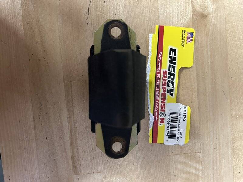

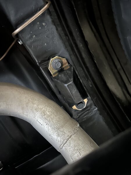

Hello fellow FABO members!
I wanted to share my recent rear bump stop replacement on the Scamp. The originals were shot and it was long overdue to replace. I came across the Energy Suspension universal bump stops on this forum and decided to go that route vs OEM type as they appear to be higher quality. After removal of the original bump stops, I compared the 2 and they are nearly identical height, width, length as well centre to centre mounting dimensions. The mounting holes are slightly larger which worked out in my favour as I ended up using larger self threading body bolts because the original OEM hardware was too loose to use from years of abuse. See pics for reference and part number. I hope this can help someone else with their project.
