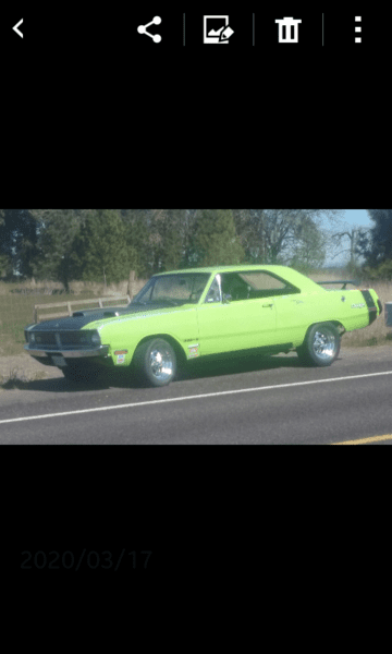

extending the bump stop May save your tires but it won't do anything for your vertebrae, you will have a ride similar to a hardtail Harley. I have 3 in over Arch HD Springs on my Dart to clear my 275. It's a little higher than I would like
