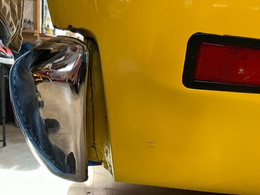

I have a '71 Duster, and as can seen in the photo the rear bumper does not align correctly with the body. At first I thought it was because someone had raised the car using the bumper and had bent the mounting brackets. Before I remove the bumper and attempt to realign the mounting brackets, I have to ask if the brackets could be installed incorrectly? By that I mean are the brackets made specifically for each side, or are they interchangeable? Rather than try to realign them I am thinking I can remove them, switch sides and reinstall them and hopefully the bumper will align better with the body. Any advice will be appreciated.
Make sure your body where the brackets bolt on is at a 90 with the bottom of the taillight section. If it is your brackets are bent. No the brackets cannot be switched. Were the quarters replaced? Here are some pictures of original cars with original quarters never hit. You are missing the rubber pads on the body at the ends of the bumper. They were never perfect

All, thanks for your input. Gives me a lot to go forward with. I do not know if the car was ever hit in the rear, but now I believe I know how to move forward. Thanks again for your responses. This site is awesome.
My guess is no. I have a tool we call "pogo stick" a pry bar hooked to a chain basically. It would align that in short work.
