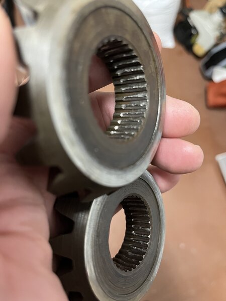

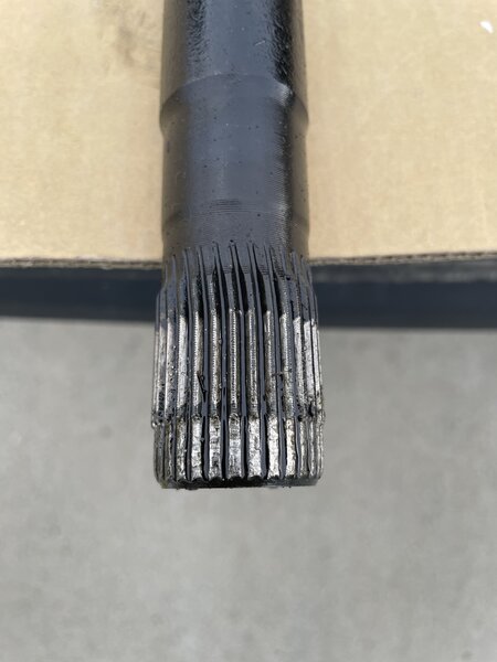

Hey guys,
I just got into drag racing my 69 dart last year broke my first parts, the rear end crapped out on me. My car has a 340 that makes 440HP at the crank, 4 speed, 741 case 8-3/4 rear end with 3.91’s, Mickey Thompson ET Street SS tires. After taking the rear end apart I found that the drivers side axle splines twisted and the inner side gears of my sure grip were wiped along with that portion of both axle splines, the outer side gears were fine. To get the car back in action and to make the last race of the season I rebuilt the sure grip with new, one piece side gears, new clutch plates, and found an old pair of factory axles. The ‘66 dated ring and pinion looked to be in good shape and I left them as is.
The last race of the the season was just this past weekend and I raced without issue and now I want to properly come up with a game plan. A lot of the local mopar guy’s think that the 8-3/4 will do just fine for my power level and that I should just get a new pair of axles and keep running it. I will say that they all run automatic’s and aren’t racing a 4-speed. I talked with Dr Diff and Cass figures if I’ve twisted axle splines than it will happen again, even with new axles so he’s leaning me towards a dana60.
I made around 50 passes last year and about the same this year and I’m hoping to keep that pace up. Down the road I’ll probably get slicks for the car and maybe coax some more power out of the car but nothing too drastic. It’s a true street/strip car.
I appreciate any advice from guys who race 4 speeds, thanks. Mike N

Your clutch is what twisted the axles. The more torque capacity a clutch has, the faster it pulls the engine down when you dump the clutch, which results in a sharper impact sent to the drivetrain. Most install an aftermarket clutch and think nothing of putting a 650tq capable clutch behind a 450tq engine, not realizing that excess clutch torque capacity is counter-productive and leads to bog/spin/broken parts problems. A proper clutch for the OP's 340 only needs about 2500lbs of clamp pressure on an organic disc to hold the engine after the shift into 4th gear. Aftermarket PP typically has quite a bit more, simple solution is to shim the aftermarket pressure plate until it barely holds after a WOT shift into high gear.
A pretty common misconception is that you only want the clutch to slip during launch, truth is there is more to clutch tuning than just dialing in the launch. For proof just look at the data logs from any fast adjustable clutch car, it's pretty common to see half a second to a full second of clutch slip after the shift into high gear. They could easily adjust their clutch for less slip after the shifts, but data tells them the car is quicker and more consistent with the slip.
Even after the PP clamp pressure is optimized for the application, you still won't have enough clutch slip for a proper radial launch. Simple way to get what you need during launch is to add a ClutchTamer. A 'tamer momentarily reduces clutch clamp pressure, which in-turn allows the clutch to slip longer than it otherwise would in 1st gear. That gives the car more time to gain ground speed before the clutch locks up, which helps keep the engine operating up where it makes more power.
