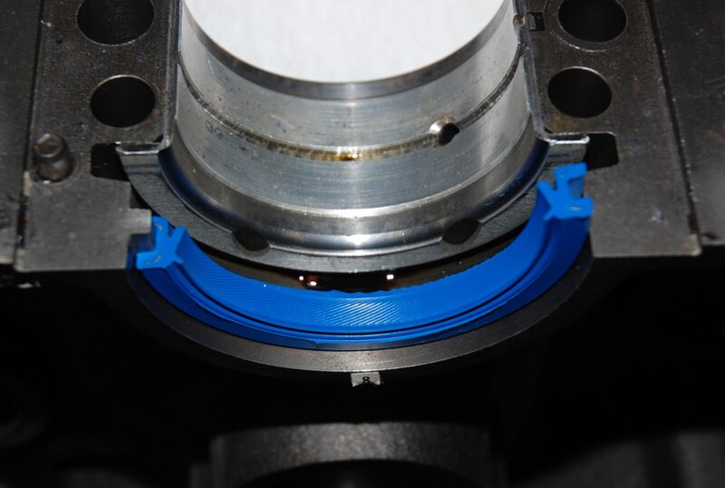

For a 2 piece rear main seal should it be installed flush with the block surface or offset like this picture?
Also should rtv be applied to the seal ends where they meet, or anywhere?
I don't offset the ends.
No sealer anywhere on the seal halves.
That looks like some new trick seal, what do the instructions say to do?
A lotta rear mains come with the "ears" attached to the seal, so you can't offset the ends .
Having said that, most other makes do not.
I have used both styles, - both ways, don't remember any leaks.
I never mess with or add goop to the ends, or any place else.
Good Luck
As like rope seals, a small amount of seal above the block allows for crush/tension upon installation. I use a very small film of RTV on rubber seal ends.
If the seal has wigs on it, you leave that half alone.
You put the other half in the block and you determine how far the seal is proud of the block.
You only want to .010-.015 proud. If it’s more than that you need to cut the seal down until you get there.
I do it with a belt sander but you need to go SLOW and sneak up on it or you’ll Jack it up. If I have a cap cutter I use that.
You never offset a seal like many do. The seal is similar to a bearing in that it has crush built into it so that when the two halves are put together they had some load on them.
If you offset the seal you change that. And if the seal has too much rush it will go out of round and leak like a sieve.
The factory never offset the rear main seal and they produced millions of engines that made it through warranty without leaking.
