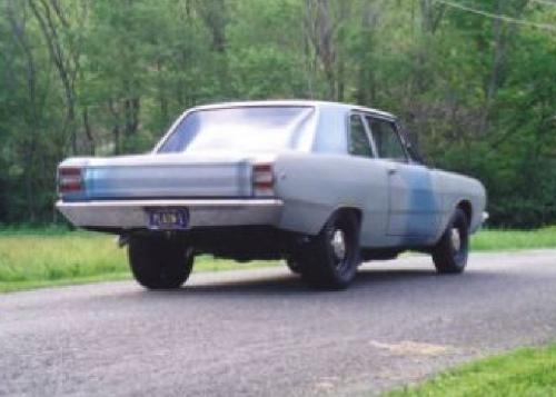

Here is my 73 with 864 SS springs and 275/60-15 tires
