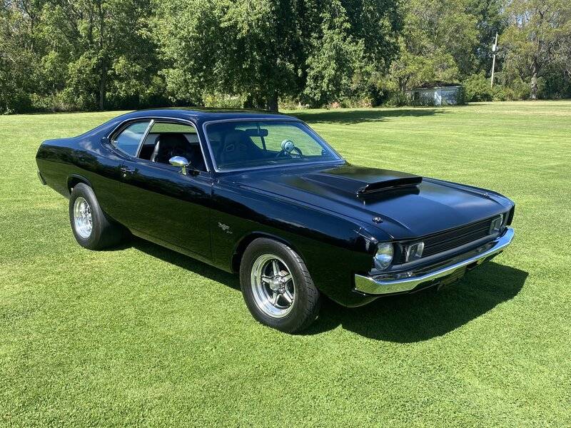

The car the tires are going on is my Demon - All steel car w/SS Springs moved inboard to the frame.
I'm presently using M/T ET Street "R" - 275/60 - 15's.
Best ET is 11.18 with a slow 2-3 shift and a tiny stumble off the line, 60' was 1.48. - that was with a 4.30 gear - was going past 6500 before the traps, I've since changed it to 4.10
I've been contemplating the M/T Pro Bracket radial slick (Pictured)
Reviews on Summitt and Jegs are decent, wondering if anyone has experience with them? Pros/Cons??
I prefer to go with the radial as I run a radial front tire, and of course that will bring up the issue/myth of mixing radial - bias front to rear.....Maybe it's just personal preference?

Thanks guys! I appreciate the compliment Dave!
Engine is a 360 based 420 cid w/Bullet hyd roller. .573 lift, 249/257@.050
Once it’s sorted out, I’d like to bracket race it a bit more and I’m really leaning towards these slicks.
Back when I raced the car in the 80’s & 90’s I had bias slicks and bias fronts so maybe just something in my little pea brain that thinks it’s supposed to be that way?
I wonder if these slicks would 60’ better than the Street R?
If I get the slicks, maybe I’ll do a weekend with each set of tires for a straight up comparison.
Pic of the car attached.
