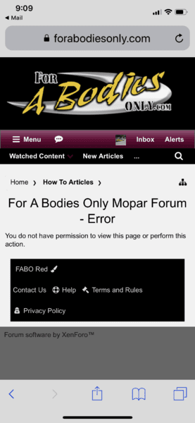

I tried to link this article to the how to section and got this reply.

That's because linking to an existing thread doesn't fit the "How To" format. I'll fix it for you...:)
