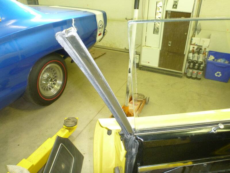

Anyone have experience removing the door glass trim for hardtop 69 Dart. This piece is stuck on there and I want to polish it. Thanks FABO
You'll need new setting tape once you pull it off. Wood block and a rubber hammer at the top and it should start to "tip off".
You're opening a can of worms your going to regret. Just a heads up. Good luck on your quest. Keep us posted. :)
