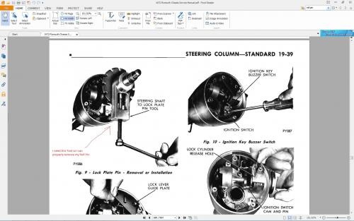

All of those links helped a lot, I am still having quite a bit of trouble on the Roll Pin part. I looked at AbodyJoe's page and he does not describe how exactly he got the Roll Pin out. I have an assortment of Punch Tools but they don't seem to be doing the job when I try to punch it with a rubber mallet or steel hammer. I found that reading those PDF files you directed me toward showed me this diagram but I can't seem to find this tool anywhere!?
67, If you know where I can find one that would be much appreciated since I tried Ebay, Rockauto, Autozone all with no luck. My Roll Pin seems to be stuck in there and this device seems like it would work really well in applying force similar to the Steering Wheel remover tool
Sorry it's been YEARS since I've done this in a locking column car. There were a couple of other threads relating to this, do a search
i had no luck finding that tool also.i did one of those today and you wont move it with a rubber mallet.get someone to hold the shaft and with the right punch it will come out.good luck with it.
