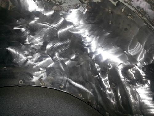

I tried all of the above.The paint remover, heat gun,torch etc. all sucked. (Actually made it worse!!)I found leaving it hard and not touching it and using a pneumatic gasket scraper(40 bucks) the stuff came off in chunks. Did both rear wheelwells in no time.
Then after all done I used a sanding flex disc on the are and cleaned it all before it was painted!!
I have tried all of the suggestions you guys have tried. Have to agree with Raaf69 it just a sanding disc forth grinder and a lot of time grinding it off. Not sure if I was doing something wrong but made a hell of a mess until I gave up. Started grinding and in a few nights I was done with it. But glad I did this since there was a lot of rust under the coating. Like some said rusting from the inside out or not properly prepped when first done.
