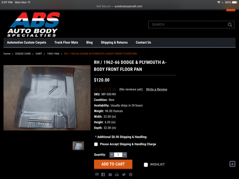

Need to replace the front floors in my 66 valiant. I can’t seem to find 66 floors anywhere but here, anyone have any experience with these?
I used both front floor pans and the passenger rear in my 65 Dart wagon. The contours were very good as was the fit. As with any repair panel there was some minor trimming to fit but not excessive.
Yup! I drove to their location from my house (about 35 mins away) they will be larger than what you want. So plan to trim them down. They are really close and if done correctly most will never even know. Both my front floors are them.
