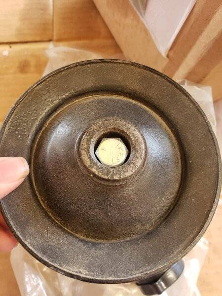

Mar 23, 2022 #1 D Donica LAnda New Member Joined Mar 23, 2022 Messages 1 Reaction score 0 Location Alamo, texas Recently bought a new power steering pump for a 66 Plymouth satellite but the old pulley doesnt fit. The old one is 5/8 and the new one should be 11/16 but cant locate pulley that will fit anywhere.
Mar 23, 2022 #2 4 413 Well-Known Member Joined Nov 13, 2019 Messages 2,014 Reaction score 3,134 Location NW USA The 66 PS pump doesn’t have a threaded shaft. So it looks like you have the wrong pump. You need a TRW pump, not a Federal pump.
