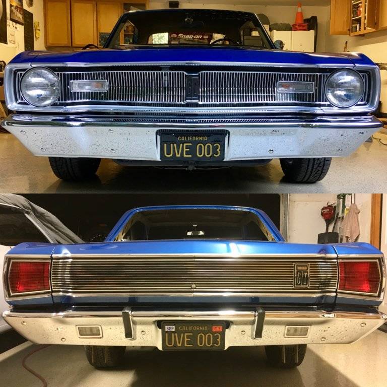

Hey BrianT... Sorry for the late response as it’s been busy at work today. I had the grille and rear panel done at the same time. I can say they worked a deal for me. The 1300 they quoted you, wasn’t what I paid for a “package” price. But... it was spendy for sure. It really make the car look complete, so the money was well spent in my opinion. Hope your get yours looking good!

If you polish up that aluminum, you will also remove the anodizing. Then the aluminum corrodes. One reason King Of Trim is more expensive is because the strip your parts down to bare aluminum, straighten/weld/polish, anodize, and paint. Lots of labor, and special chemical processes involved. But it appears his prices have gone up a lot since I had my parts done.
