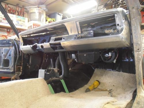

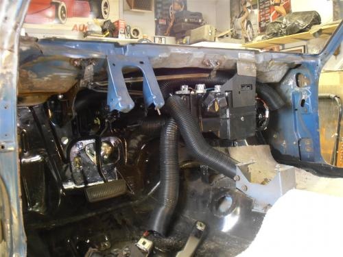

I have the Vintage Air Gen 3, Sanden compressor, condenser and hoses. I went with all new matched parts instead of retro fitting old stuff. Remember piston compresses don't like 6000 rpm, rotary compresses don't mind. I wanted it to work the first time. The hoses are running outside the rad support mainly to keep the engine bay clean but I think the routing would be difficult if it was in the engine bay. My dash is out right now for a complete wiring harness so I can take more pics if needed.
Great pictures. What all on the car did you have to change or fabricate to get that to fit?
