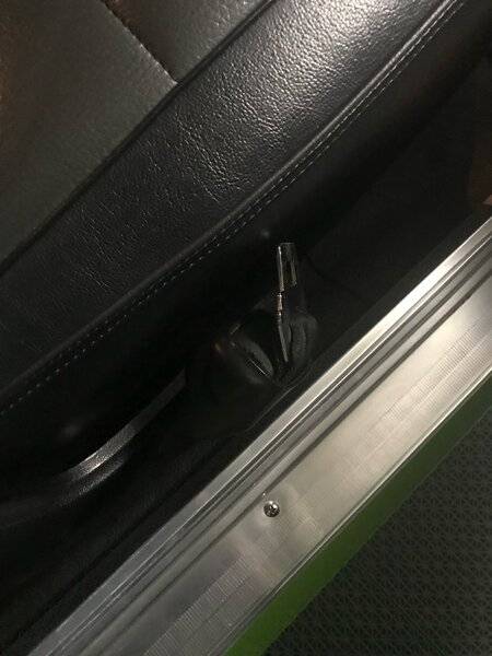

I am having an issue with the the retractor housing hitting the door panel and the hinge cover when closing the door. The belt is currently on the outside of the housing which I suspect is incorrect. I also found the seat studs spacers are missing. 1969 Barracuda with Front Bench Seat.

Maybe the seat stud spacers being absent ( bench sitting lower ) are sandwiching the retractor between the hinge cover and door panel. Does your retractor pivot forward/down when not in use?
It will pivot forward and down. I am now of the opinion that the seat belt retractor and belt assembly does belong on the outside of the plastic cover and once I raise the seat with the spacers the issue will be resolved.
If the belt look like the one on post 7 then it is normal
You can move the retractor a bit which will wind the belt up a bit more.

I just looked at both my 71’s and they are the same as how you have yours in the photo.
The belt on the inside is correct.

The winding is not the issue, it's the housing. I need to go out to my storage tomorrow and check something out. I have been studying a lot of photos of other cars and I have hunch. I will share my findings tomorrow.

You are likely on it! The new stuff is slightly wider! Looks the Same but!
I will measure my originals tomorrow and report back.

Original is about an 1/8 " thinner. They also have a compound bend in them the reproduction ones do not have. Passenger side is the top one pictured. Belt to the outside.
Obviously I have mine in backwards based on the bolt markings from the originals at the mount location. This would likely give an extra inch of room.
Hope it helps and assume the Bench seat outer belts are the same as buckets.

I am not yet convinced about the belt on inside being correct. I have been looking at a bunch of cars and most have the belt on the outside!

I think we are on to something now!
Driver side pictured. Note the original has a slight twist near the middle and a bend at mount hole. My originals were dyed and painted black.
Which is why I replaced them.
Mine are installed correctly but there are no bends in them. Another thing tha I need to consider, I have not seen any bench seat cars. My '71 Duster did not have retractors and I wonder if a bench seat '69 Barracuda should even have them. Here is a pic of my Duster.
