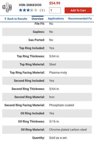

I’m partway through building the bottom end of my 383. I was just about to gap the piston rings but when I test fit them they won’t go in the grooves on the pistons…
Do I need special rings or something? 30 over TRW L2293 dome pistons and Hastings 30 over moly rings.

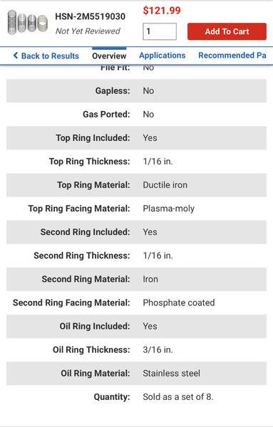

Probably 1/16th rings vs the stock 5/64. About a .020 difference. Several sets of those on eBay list 1/16th rings.
You'll need new rings. But a simple feeler gauge check will confirm the thickness.
That piston uses 1/16, 1/16, 3/16, rings. Buy the appropriate rings and you’ll be set. What do yours measure?

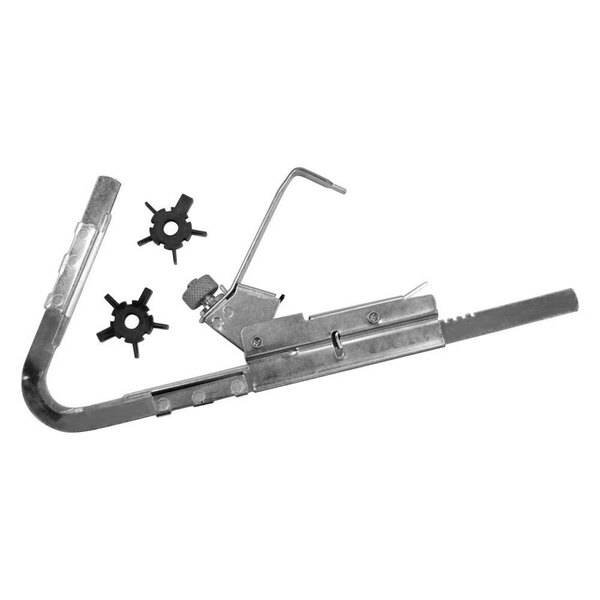

Do a couple of circuits around the ring lands with a piston ring land tool. Even though your pistons appear to be clean, you will be surprised at what comes out.
