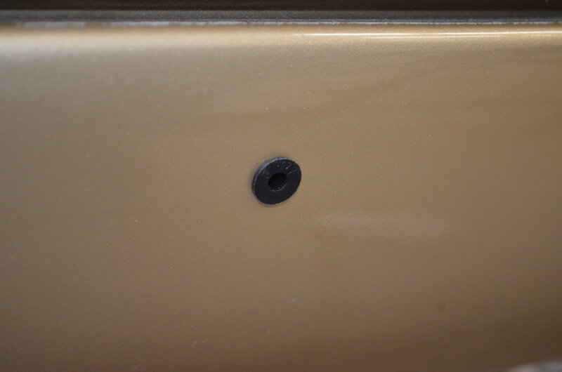

Finding new or unbroken rocker molding clips for '65 Barracudas is very difficult. Whatever you do, don't throw out the originals, they can be reused at very little cost with this simple method. The rocker panel holes the molding attaches to are 5/16". Well nuts are the answer! From Amazon I bought a package of 25 ea. 5/16" (hole size) well nuts with an #8-32 thread. I used flat head stainless screws #8-32 x 3/4" long.
Well nuts: Amazon.com
Screws: Amazon.com

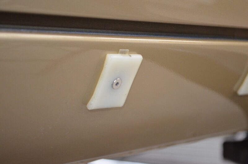

I removed any plastic flash left over by the broken clip part that goes into the rocker holes. Then gently, with a drill bit just a bit larger than the diameter of head of the flat head screw, cut a recess area in each clip so that the screw head is nearly flush with the face of the clip so it doesn't interfere with the molding once installed. These work great, and actually seal the holes while they protect the paint on the rocker. Because my moldings still have to be painted, I haven't installed them yet, but I see no issues in these doing a great job. They can also be removed and reused if needed. The screw are stainless steel, I chose the Allen head type because it was the widest head I found for this screw. Thanks goes to RT Specialties for the idea to try this.

Is the head of the insert too thick to allow the clip to sit flush?
The molding attaches the same way, but yes, the well nut flange is under the clip. Its rubber, and presses down nicely, I don't foresee an issue with the slight thickness of the compressed rubber with the molding attached. When I get the moldings painted and installed I'll post pictures.

I like the waterproofing aspect. Would a riv-nut sit more flush and with some sealer work?
I do like the removable aspect of the insert
I thought of those and jack nuts, but the flange won't compress, and I couldn't find one that fit a 5/16" hole without enlarging it. Not only that, they become permanent once installed, and they are hard on the paint and can expose raw steel once installed.

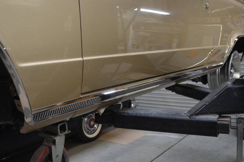

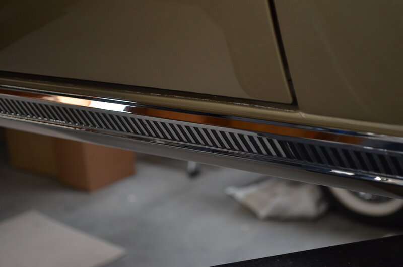

I finished painting the rocker moldings and installed them yesterday. They fit perfect, snapped into place just fine.
Looking good Bob. You have done some really nice work on that car. The 4 speed tunnel and install was well done. Keep up the good work!
