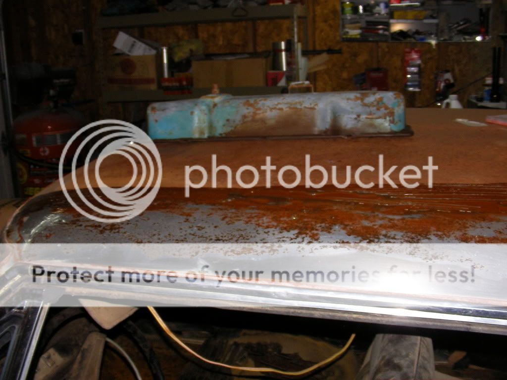

This is actually something I am dealing with right now on the roof of my roadrunner. I tried sanding and other things but they didnt work. And this car sat outside with most of the vinyl top missing for 30+ years, so the whole roof had rusted. Anyways, I bought some of Eastwoods "Rust Dissolver Gel" to try. To my surprise it actually works pretty good to remove the rust. Most of it was gone after the first night (you apply the gel and then leave it on overnight, and remove it the next day). It tried it on a small (about 1/4 of the roof) section to see how it would work. It took three applications to get it all of on the section I am working on.
After one coat:
After three coats:
I plan to finish the rest of the roof this week.

Now on this Eastwoods "Rust Dissolver Gel" does it convert rust, or just remove it?
Follow waggins lead. Also if you paint the roof and then install the vinyl top(after scuffing the paint some) you shouldn't have problems with future rust. The factory didn't paint the roofs on vinyl top cars.
It removes the rust. If it still looks rusty in the 2nd pic, its the lighting on the pitted areas (it leaves the metal rust free, but not perfectly smooth). This stuff will also remove the paint, so be careful not to get it on any painted areas. I paint the gel on with a brush at night, and remove it the next morning or day. If I leave it on for more than 24 hours the metal begins to rust again (so I wipe the stuff off, and apply a fresh coat if needed).
