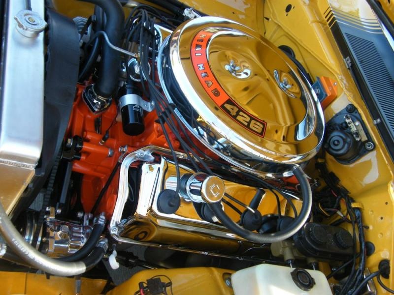

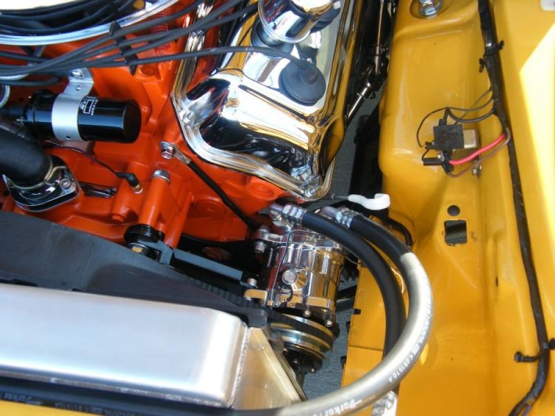

I made my own (laser cut) A/C mounts for the (shorty) compressor on my 426 Hemi. The compressor is mounted low and out of the way in the area where the power steering pump would be. Also incorporates the 2 groove off the shelf pulleys from March Performance and a belt tension/adjuster mounted to the extra lug on the upper drivers side of the water pump housing used to mount the power steering pump.
Mounted low helps keeps the Muscle car look/visual when the hood is popped

Some pictures from Denny
attachment.php
attachment.php
Thanks Old Man Mopar for the pics. Seems like you have more pics of Dennys cars than Denny
Denny do you have problems with the A/C being not cold enough since lines are running behind and touching the rad?
No issues....Only the larger line runs near it. The smaller line runs to the stock condenser mounted in front of the radiator...then thru the dryer before heading inside.
My radiator stays @ 180 degrees per thermostat.....same as the block. I had concerns that I wasn't getting enough heat in the motor so I checked it with a infra-red, I was amazed how consistent the temp was....stayed right on 180..... except the headers
The placement of the refrigeration lines will have no effect from other sources as per heat and such. But I do suggest that anyone using their existing A/C system parts to UPGRADE the condenser for a larger condenser (the finned item in front of the radiator) for the R-134a refrigerant. They system Denny and I came up.... I have NO issues with cooling the car no matter what the temperature is outside. Denny's talent for coming up with his own brackets was great and the guys (Dwight) at Classic Air was really great with customer service and making a few different refrigeration lines until they got it correct for what we wanted and needed.
Ok sounds like it would be no problem to put it there then cool. Wow that motor stays really cool and constant. Must be a great performing radiator.
