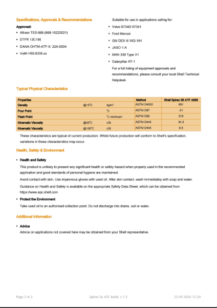

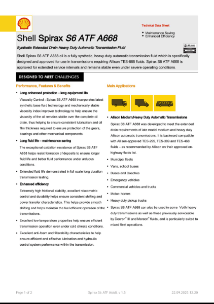

This is a screenshot of a PDF I downloaded. I'm not sure how well it will post. If you can't read it, I can send it to you via PM.
