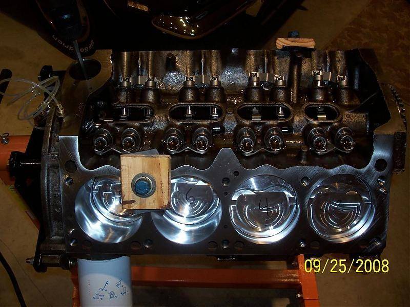

Sent the cam back to Comp. They looked at it and said it can be reground with a .030" smaller base circle so that is what they are going to do. That should provide at least .025" of oil groove coverage at max lift.
Getting lifter bushings installed is anywhere from $500-$700 depending on the shop. Yes, it is extremely expensive. But my understanding is they have to have jigs for a small block mopar in order to do it. And I wouldn't let them do it unless they have done a small block mopar before. Its not the same as a small block chevy.
You can have the bushings drilled for oiling prior to being installed for hydraulic cams or if you want the lifter to have pressurized oil for push rod oiling.
What he said. Although the CNC Rottler doesnt need a jig ;). It costs me $500 with the bushings and .035 holes in them. I dont like strictly relying on splash to keep them oiled.
The new smaller base circle cam was delivered today. All the lifters are now well covered both at the top and the bottom. Ran the oil pump and I get a steady 80 PSI no matter what orientation the cam sits at. I see some bleed off on all the lifters but its slow and steady so oil pressure should be excellent. Brian at IMM stayed with me and got the problem solved.
I think I am going to tear it down, clean the block up, and start measuring piston ring end gaps.
Nice job Bill. Do you recall what the final base circle diameter ended up being?
Brian is a really good helpful guy.
Looking forward to seeing how it runs.
I am using Comp Cams Pro Magnum roller rockers and I need to measure and order custom length push rods.
I don't know what the specs on the base circle are but the base circle is almost down to the shaft of the cam.
