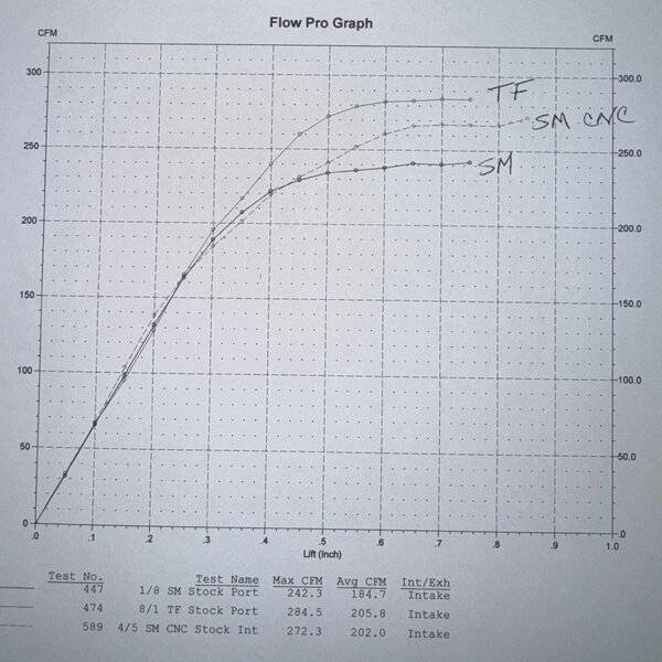

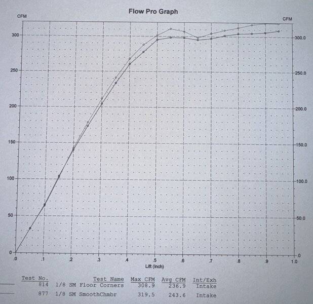

Here's how the stock SM, the CNC SM and the stock Trick Flows tested on my bench. All 2.02 valves.
Porting the SM to 270-280 is not that difficult, especially if using a 2.055 or 2.08 valve. Getting to 300 takes some work and some testing/cutting machinery.
One of the guy's at TF said for their street heads they really focus on flows between .300-.500" lift.
Imo, the curve on the cnc SM is as unimpressive as it is because it’s poorly executed.
With a more refined throat and valve job, the numbers in the middle could be noticeably better.
They’re in it for the quick cash and banking on the CNC buzzword for sales.
It’s pretty bad when there are areas near the middle of the curve where the ootb untouched head is better.

Without getting into too much detail and derailng this thread, an example of what I’m talking about are these results from a CNC ported BBM head.
Without doing any work other than in the immediate seat/bowl area(no additional porting in the runners), by implementing a more air flow friendly seat profile, adding a small back cut to the valve, and blending away a little ridge around the OD of the valve job I was able to pick up:
4.8@.300
15.7@.400
15.7@.500
15.0@.600
13.8@.700
With basically zero gain in runner volume.

SM and TF coolio indeed, no drop off at .550.
300cfm is a great number for both Big and Small block.

I have no idea where this is going. I'm still learning and trying to figure some things out, not the least of which is that irritating dip at 0.650" lift. Nonetheless, it was a productive week. Here's the results of about 60 modifications and flow tests. Thanks for the interest.

IMO at that lift you are dealing with a seat/chamber issue.
How to address it is the question.
The 50 degree valve job certainly takes a bigger hit up there.
Have you tested the ports just like they are at the highest pressure your bench will pull and then say maybe at 10 inches and see what those curves look like?
That may get you going in the correct direction.

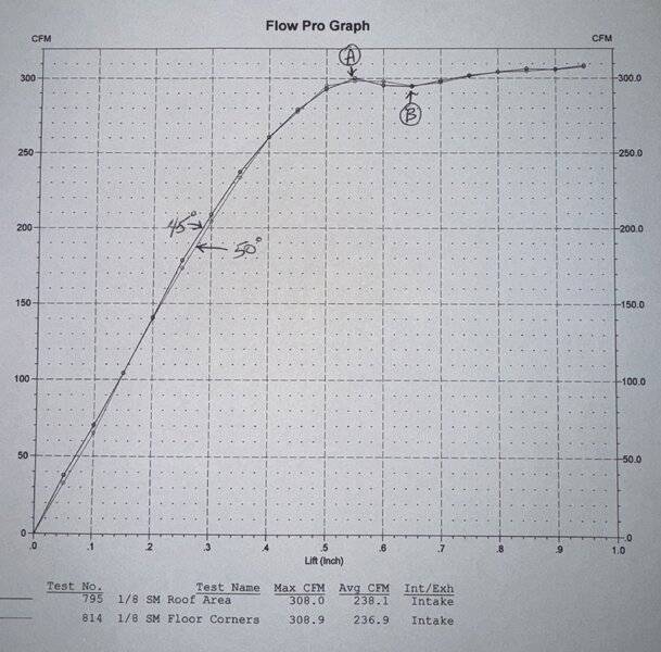

Are you saying a 50 deg seat will dip more than a 45?
No, I’m saying that looking at your flow curves the 50 took a bigger dip than the 45.
I forget the valve size exactly but at a 2.055 valve the .25 l/d ratio is .5138 lift and a 2.08 valve is .520 so you should be well past where the valve has a bunch of influence on the flow curves.
I’m a bit bewildered by that curve. Usually at high lifts the 50 and steeper seats don’t do that if the port has the cross section to support it.
Have you put the valve in the guide from the spring side and flowed both ports??
That may get you going the right direction.

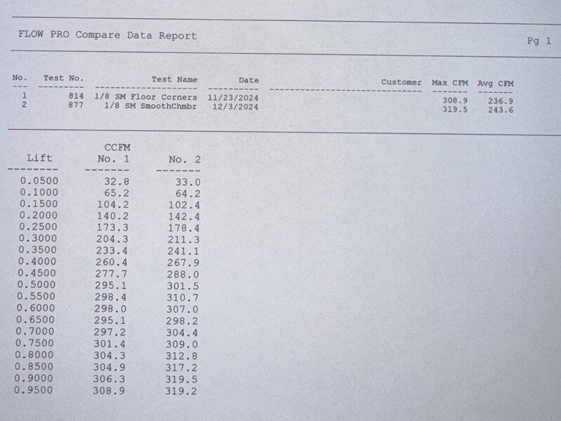

Sorry for the confusion, but the two tests shown this time are both 50 deg. They are the same port, just showing the progress over 1 week. 1/8 identifies that it's cylinder 1 or 8, then the date is shown.
So, the bigger dip is a result of lots of work on the short side and some in the chamber.
And it is definitely an area thing. Once the short side is lost, a majority of the air is going over the valve and toward bore center. Finding area in the 0.550"-0.650" lift range is the key. It's hard to do. Laying back the short side helps some, but eventually the mid lift flow will suffer. I'm going very slowly at this point because I have a pretty good port going. Don't want to mess it up.
Haven't flowed with the valve upside down lately, nor have I tried the different test pressures. Maybe I'll try that in the morning.
Ok, I got it now. I’d test with different pressures and then flow the port with the valve upside down.
I think that might give some direction.
But your flow curves definitely have a strange dip.
I’ll be glad to learn what it is when you figure it out.
I think it could be chamber shrouding on the long side. The valves are sunk 0.080 to 0.090. This means there would be that much additional shrouding on the plug side. Look how quickly the flow rises at 0.700-0.950 lift. The valve is getting clear of the chamber. I bet a surface cut on the deck face would clear it right up.

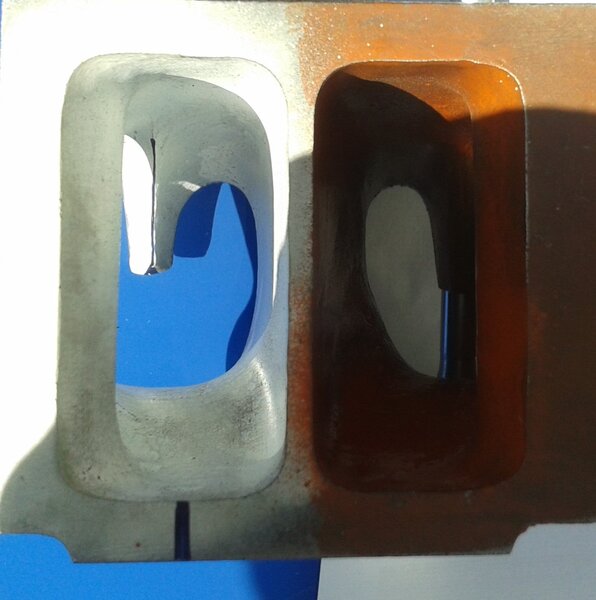

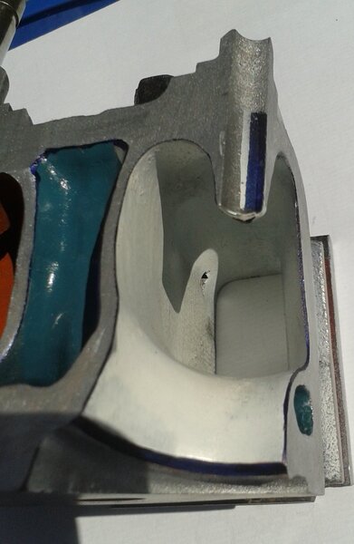

I am going to compare the SM head to my Weslake 'J' head cutaways.
Much taller port floor and a slight ''wall hump'' as per all late Mopar iron heads.
The area open to the valve, next to the port wall is tiny in comparison.
That hump on the floor at the common wall is a problem area and a danger area for sure. The port on the left looks quite nice!
