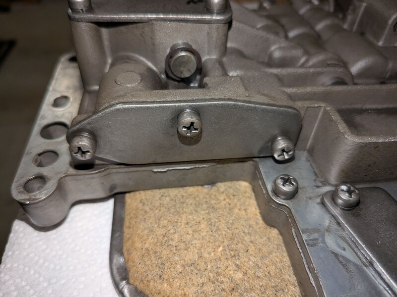

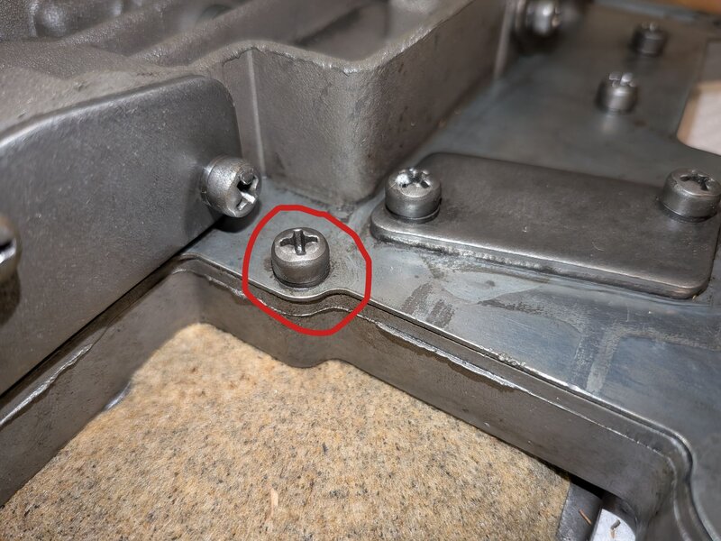

The part throttle kickdown assembly from the 1971 and later valve body pictured can be added to the 1970 transmission valve body. Note that one screw on the separator plate to transfer plate must be changed to a low profile thin head screw.

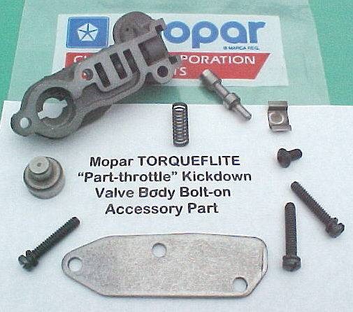

The part throttle kickdown unit mounts in place of governor plug end plate on the 1967 - 1970 valve body. The governor plug end plate is shown in the following image:

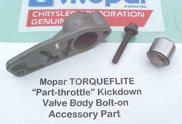

1967 - 1970 727 transmissions can be modified using the early A904/Slant Six factory parts by replacing the governor plug end plate with the part throttle kickdown unit. 1971 and later transmissions that do not have part throttle kickdown and use the earlier style valve body with a four-screw shuttle valve cover plate, such as shown in the following image, can also use this part throttle kickdown unit.
The early part throttle kickdown unit cannot be used on 1971 and later transmissions with the later style part throttle kickdown unit and upper valve body which has a six-screw shuttle valve cover plate and uses the later part throttle kickdown unit.
The early A904/Slant Six unit replaces the governor plug end plate with its housing, plug, and longer screw. Two of the original screws are reused. The following image shows the components:

1967 - 1970 727 transmissions can be modified using the 1971 and later factory parts by replacing the governor plug end plate with the part throttle kickdown unit.
The 1971 and later part throttle kickdown unit is more complex than the earlier version but mounts in the same spot on the 1967 - 1970 valve body. The later unit will function the same as the earlier unit, but the limit valve which limits the maximum road speed will not function due to the other differences in the upper valve body.
The 1971 and later part throttle kickdown unit replaces the governor plug end plate with its housing, throttle plug, limit valve, limit valve spring, limit valve retainer, cover plate, thin head screw, and three longer screws. The following image shows the components:

The part throttle kickdown unit assembles as shown in the following diagram:
Note that one screw in the separator plate to transfer plate must be replaced with a thinner head screw to clear the unit’s housing. This screw position is not used on the later valve body. The screw to be replaced is shown in the following image:

NOTE: One screw in the separator plate must be replaced with a thinner head screw to clear the unit’s housing as shown in the following image with the unit installed:
