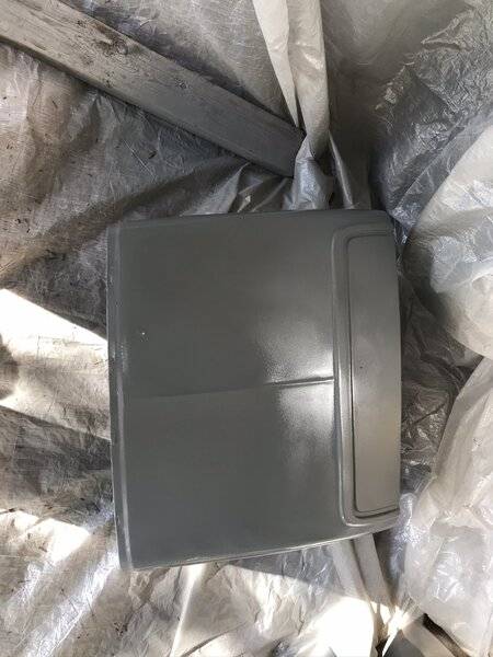

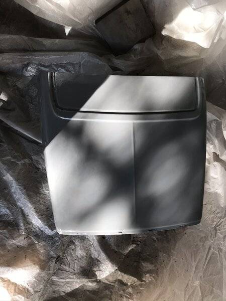

Hey I had the same dilemma with my 67 barracuda. Ended up stripping them, coated them with primer, now i am going to carbon fibre wrap them. Stripping them was a pain in the ***.

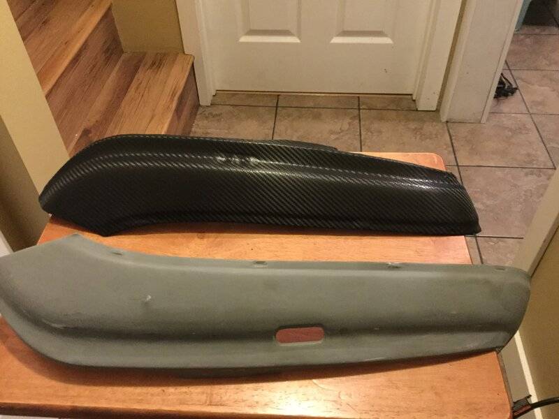

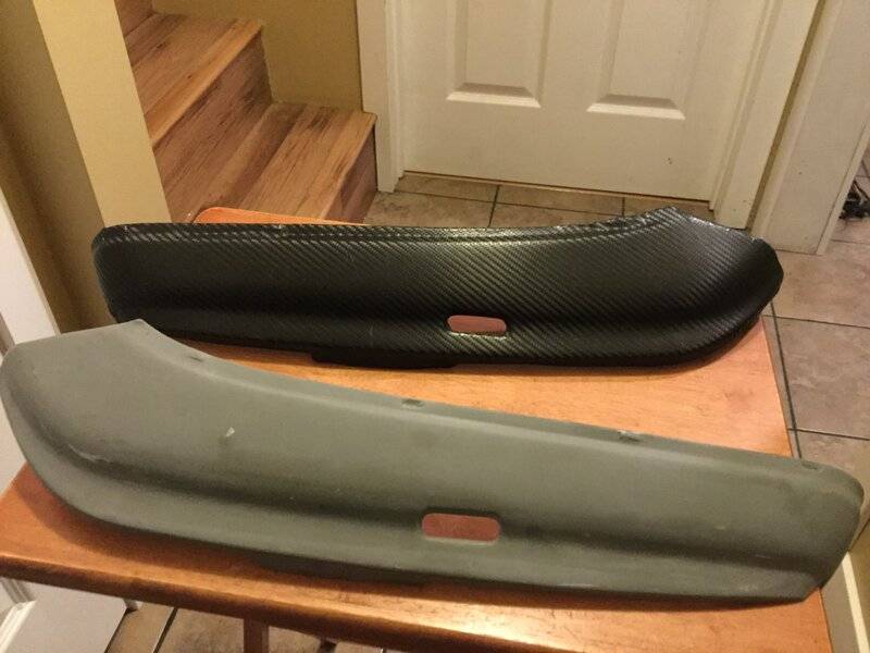

Started carbon fibre wrap on my seat parts. Here how the first piece turned out. This part is a little tricky.
