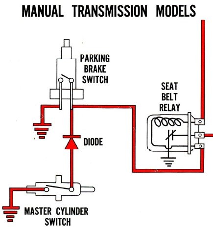

Start
http://www.mymopar.com/index.php?pid=31
Click the Master Service Tech Conference Library
http://www.mymopar.com/index.php?pid=117
"By Model Year"
http://www.mymopar.com/index.php?pid=403
"72" of course
http://www.mymopar.com/index.php?pid=429
And scroll down to the "72 seat belt warning system"
Download the pdf and click the video
Notice the vid is hosted at YouTube. If you have something like Firefox with a video downloader ad on, you can download and save the vid
[ame]http://www.mymopar.com/downloads/mtsc/294.pdf[/ame]
[ame="https://www.youtube.com/watch?v=gg0geLWGpWg"]Chrysler Master Tech - 1972, Volume 72-5 1972 Seat Belt Warning System - YouTube[/ame]
Diagrams out of the above pdf
