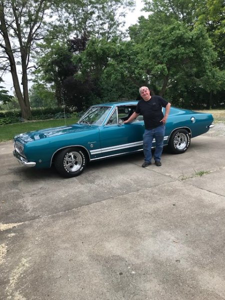

1968 Barracuda 340 Formula S. I am going to do away with the rear air shocks by adding another secondary leaf in the rear spring packs, to increase rear tire/fender clearance. What does the brain trust recommend for shocks on all 4 corners. Not a drag racer or a corner carver, just a nice stock street cruiser.
