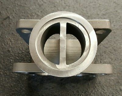

Regardless, what I do know for sure is if you don't merge 4 into 1, to prevent boost creep or leaning out the other 2 cylinders when the WG opens, you'll probably need a Wastegate on each pair of tubes, so 2 WG per turbo. 1 WG per turbo seems more simple.
Or this
a>
