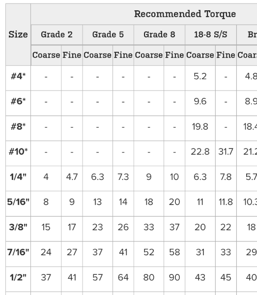

I would remove and inspect all of them. But, for years, auto shops would tighten lug nuts with an inpact wrench and no torque wrench..It's easy to tighten to 100+ ft/lb. Without damage. The smaller 7/16 diameter studs can't handle a lot of torque though.

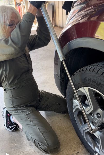

A few months ago, our oldest daughter took her Honda CRV to a local shop in an attempt to find a noise in the right front area. They gave an estimate of 5500 bucks to replace all ties rods, rack assembly and struts. Wound up being the CV axle on that side discovered by me. When I got to it, I'd use my 1/2" air impact, but wouldn't budge the lug nuts, so bring out the long breaker bar, that didn't do it, so put an "extension" on it and that did it! I never have used a torque wrench on lugs, I know what's tight enough;)

Drum brakes are more forgiving of excessive torque, but disc brakes can get distorted by an ape man with a rattle gun set to "kill". And as mentioned, the studs (especially 7/16 studs) will take a serious beating, if not fail right off the bat.
