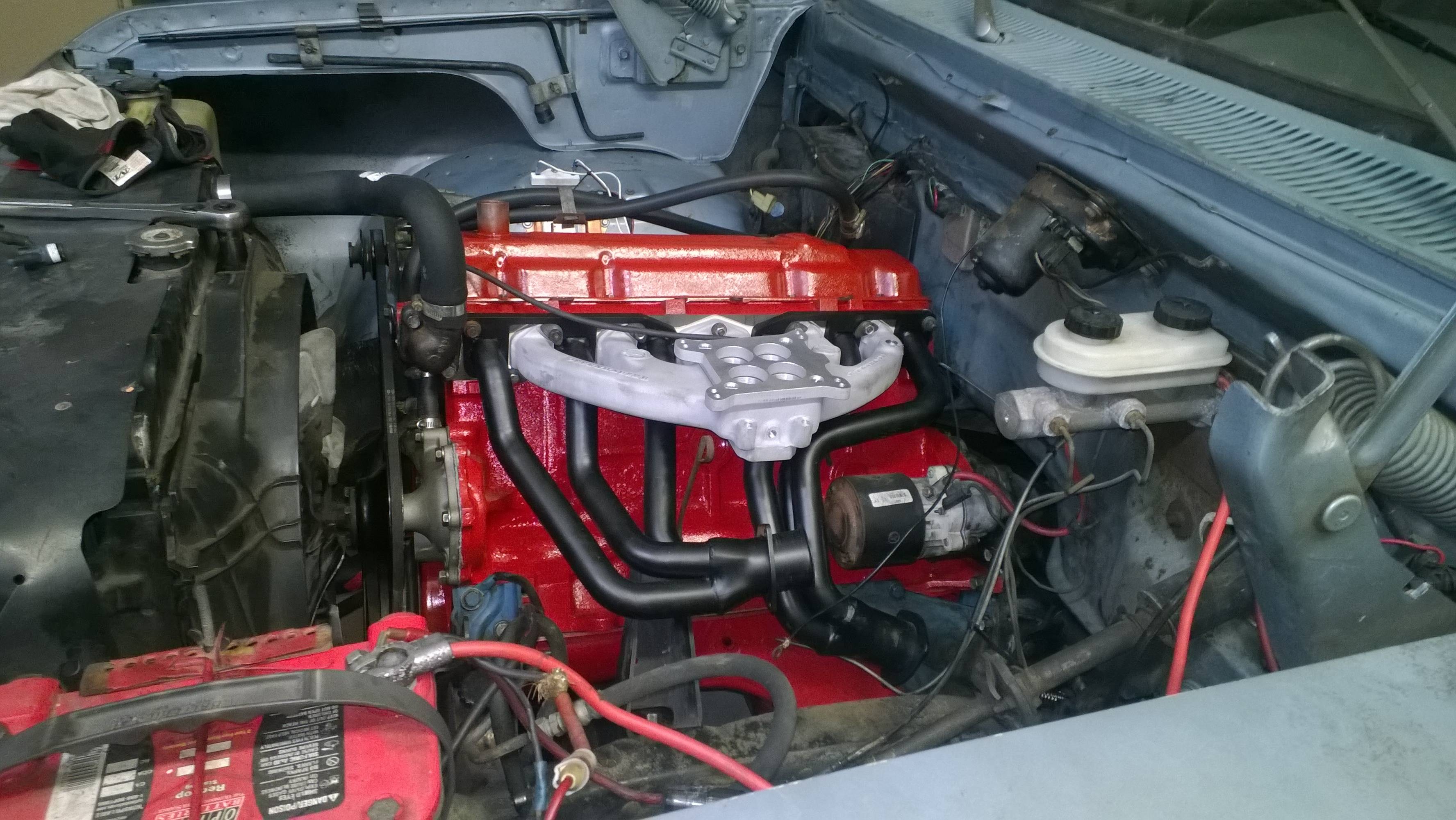

Doc 540 (Colt) if I put that Clifford intake and headers on my stock slant, will it run right? Is that the intake they say you have to run coolant through?
May I jump in on your question? The Clifford intake is not quite as street friendly as the Offy - more of a race orientated manifold with no provisions for exhaust heat. Yes, there is a water sandwich plate that coolant via the heater hose warms the manifold. And yes, the Clifford requires you to run headers. You mention adding them to a stock engine - without raising the CR by either decking the block and/or cutting the head, head work (port work/OS valves), cam, etc, - you will be disappointed in the performance. I did the just the Clifford intake and headers to my stock 65 Dart way back in 84 and although the exhaust sounded good, the performance hardly increased.

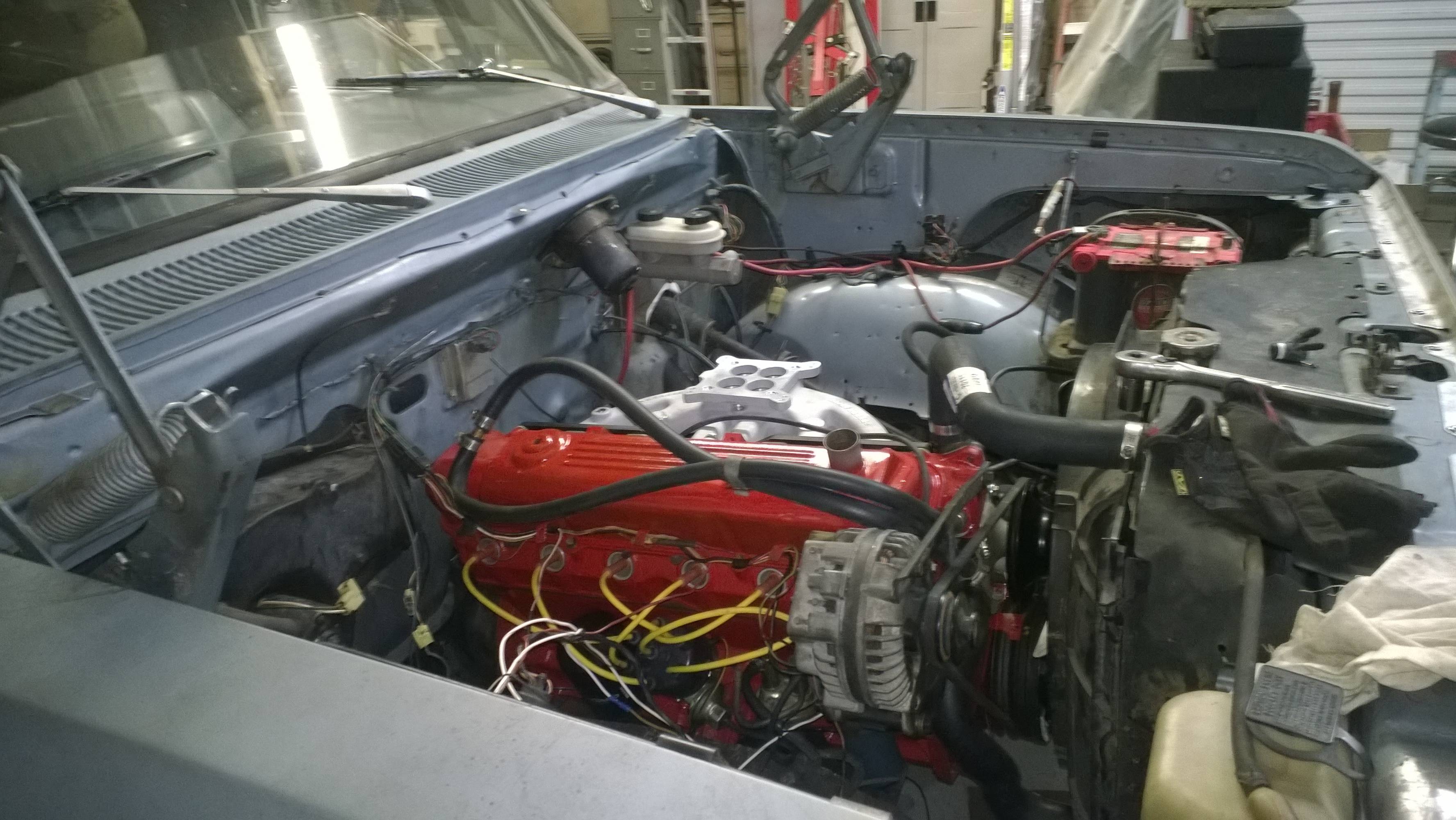

Am doing it a lot different with my wagon this time- block decked 90 thou, head cut at least 10 thou, mild port/polish, 1.70/1.44 oversize valves, 340 valve springs and depending on head gasket thickness will run a CR of 9.4 to 9.7. The cam is pretty stout to take advantage of the mods. I will use my Offy 4 barrel and if I need more, I'll go to my Dutra Hyperpak. I plan on running the FiTech injection. Long tube headers will take care of the exhaust.
Good luck whichever way you go!

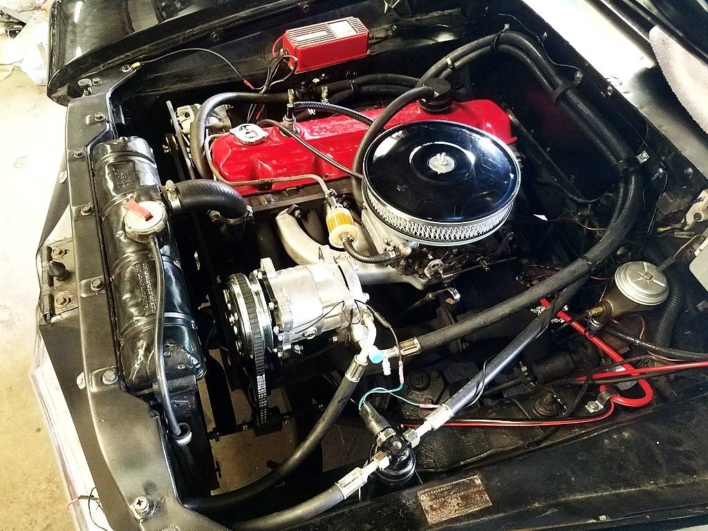

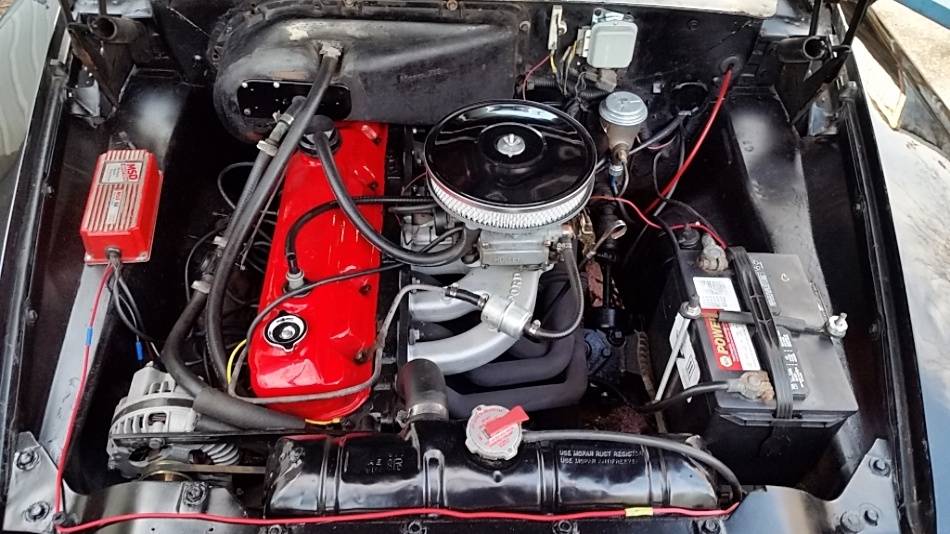

Good friends 74 Duster ,Just overhauled . We are just putting some miles on it now.
Furiousvip ,
Looks great !What carbs do you have on it ?
Here's mine. Fresh rebuild on 67 Slant in my 81 Ram.
Crane Cams, hydraulic lifters-Duration 260/260, Lift .440/.440
Offy intake with Holly 390
Clifford shorty headers
Best sounding slant I have ever heard, sounds like a V8 haha!
