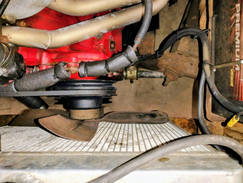

I have the 15 series belts as well. (Goodyear) I am concerned about pulley seating. I have spares in the 15 wide belts already. Is there any source for 13/32 wide belts besides the odd NOS ebag sellers? So far haven't seen any problems other than a slight chirp at start up. I have the CVF pulley/bracket system so stock lengths don't work. Mine are 50 and 60 inches. Crappy shared PS setup I know, but it is what it is. I am mostly concerned with the AC belt being problematic at a later date when I have the system operational as it is a single belt.

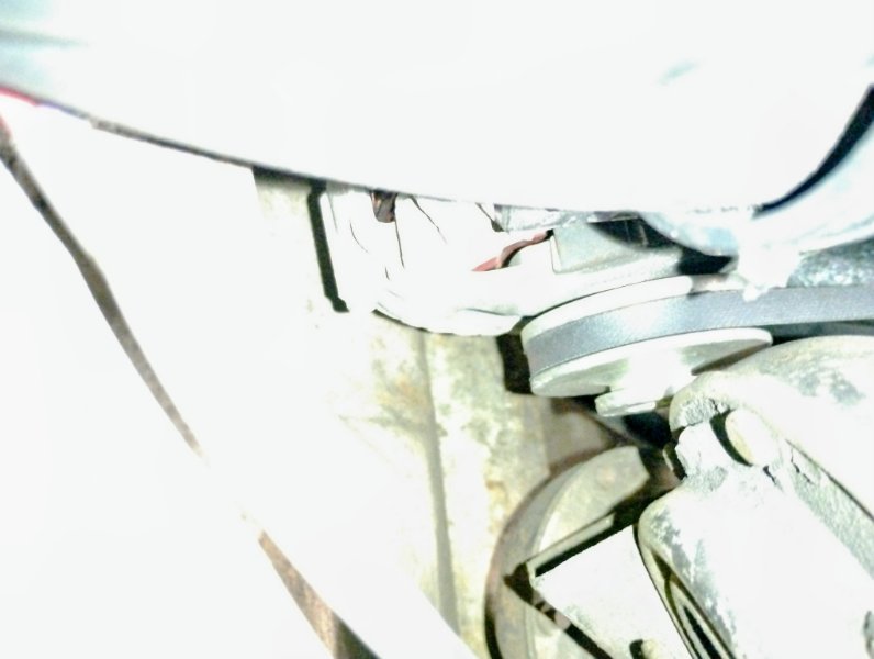

The alternator belt is the only one I'm aware of that uses (or is supposed to use) the 13/32" belt width. I "don't think" the P/S belt uses that width. I could be wrong, so it's probably best to see what the factory service manual says. In that picture up there that @Kern Dog posted for example, to ME it doesn't appear that the belt is riding deep enough in the pulley. Again, I could be wrong, but it somehow doesn't look right. IF that belt is indeed too wide, it's not making good contact on the sides of the "V".

And see......here's the thing. YOUR Gates belt above shows to be 3/8" wide. So it should fit better. It doesn't.
