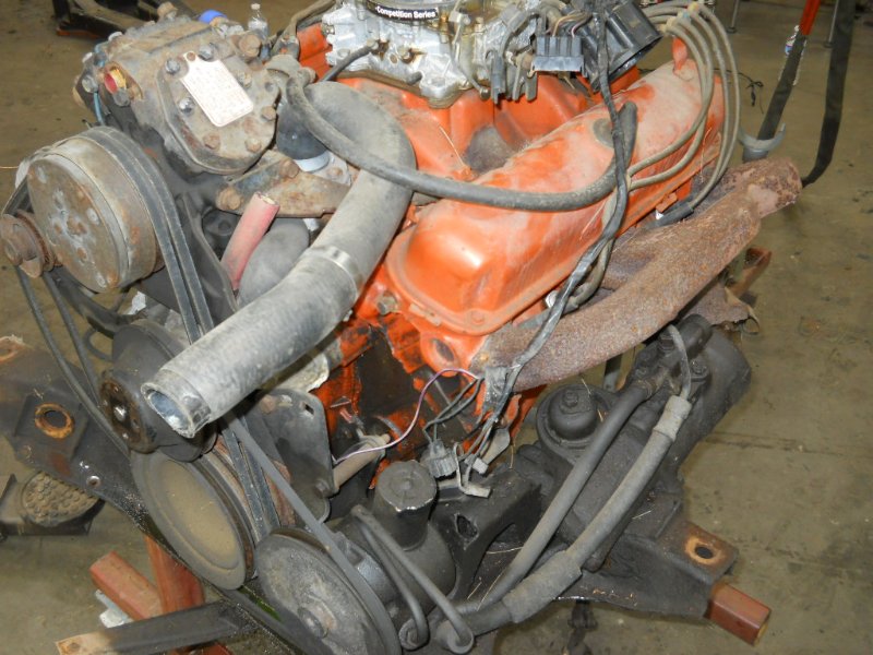

Get us a picture of that belt eater.
Pictures of pulley alignment etc may be helpful.

Your missing the spacer bushing on the power steering bolt . That will make the pump go out of alignment under torque That's your problem. If you need the spacer bushing I have them. I am in Pa. You will need to pay the shipping

Up near the top of the page, Oldmanmopar noticed that my car was missing the spacer bushing that goes in the power steering bracket. He suspected that was allowing the bracket to flex under torque, breaking the belt. He sent me a bushing which I've installed.
I drove the car back to the storage unit last night, stopping to fill the tank along the way. The squeal I used to hear under acceleration was gone. I thought it was coming from the transmission, but it could have been the PS/fan/water pump belt.
