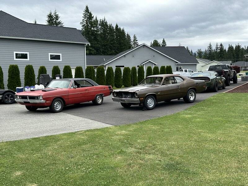

p.s. Can't wait to hear whatcha run with that car!!
p.p.s. From that pic, you clearly own too many cars!!!! You should just give one to me to keep for you!
