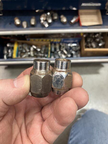

I run mags and can't guarantee you because they are shank fit, but I would put 20 bucks on the lug nut taper sitting in the hole just fine. Now I will go out to the shop and look at both styles of lug nut....... I gotta know too!
1/2” on the left. 7/16” on the right. Obviously these may be different than yours, but the outer dimension of the bore is the same. The 1/2” is just way thinner.
I guess it will depend on whether they are 3/4" or 13/16" as that could be a larger mating surface.

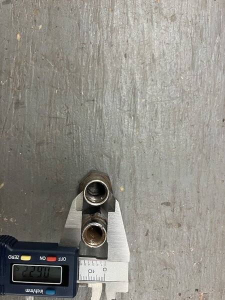

I went out back and measure the conical seats on a set of sbp wheels vs bbp. Both wheels had .530" ish holes. The taper on the bbp wheels was wider than the sbp wheels. I think you will be okay.
