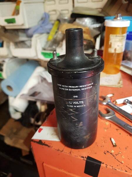

Lemme explain....so our car is a 67 cuda. 273, 904, BUT I've "upgraded" to 70+ voltage regulator and alternator.
It also has elec ignition(1st came out in 72 or 3? Now we know that the alt, vr, ecu, and ballast resistor are linked together.
When thinking my electrical issue was coil related, I started digging for specs...well what year of specs? 67? Apparently with points, ballasts/coils these were specd different?
So now we move to 72/3 and up for elec ignition and those coils/ballasts are specs differently. I found several differently rated coils and br's?
I looked thru a couple FSM and couldnt find ratings for ones with elec ign.

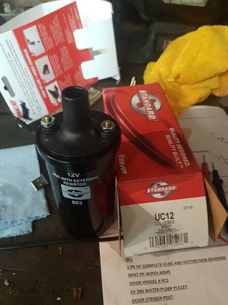

My br in car is 0.6 ohm? Is it correct? Dunno...my coil in car is is 1.4 ohm primary and 8.49K ohm 2ndary. Correct? Dunno but it's in ball park from what I've found.

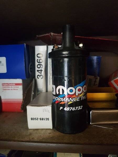

The MP backup coil I have measured 0.8 ohm primary and 4.39K ohm 2ndary. Basically 1/2 the resistance of the coil in car. I bought a new coil by SMP #UC12 1.49 Primary and 8.75K 2ndary. Identical to what's in the car.
Using Ohms law, changing the resistance will change the amps(when volts remain constant). I'm electrically challenged, but I know the life of our electronics(ecu) is largely dependent on the size of the amps?
With the coils and br I looked at, if I'm thinking properly, 1/2 the resistance would theoretically mean double the amps(if v is constant). Damage may or may not occur?
My br is 0.6 ohms, seems to be about 1/2 of what I've seen online?(1.2).
I have a RU37 SMP br ordered, we will see what it ohms out at. It apparently is a match to the coil UC12.

So, I'll ask again, anyone got factory specs for coil, br and ecu for a 73 dart?
The specs are in the FSM for the '70..........
I imagine they'll be in the '73 as well..........
I believe you MP coil is equivalent to the MSD Blaster II maybe(?).
