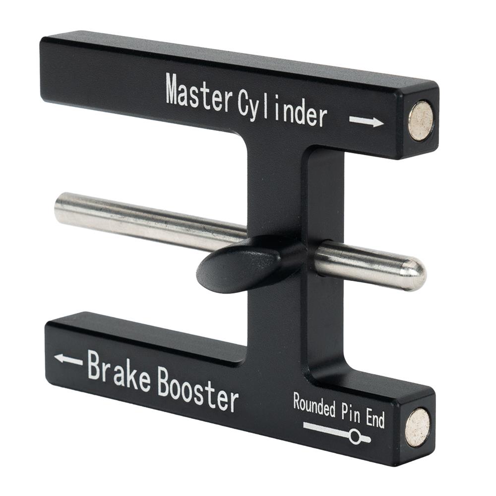

There's a small, inexpensive tool available that measures the clearance for adjusting the pushrod into the master cylinder. Get one of those and use it.

The piston rod length that several members brought up was an issue. Using the tool they suggested, the rod was about 1/4 inch too long, so I adjusted it. I'll take it for a road test tomorrow.
