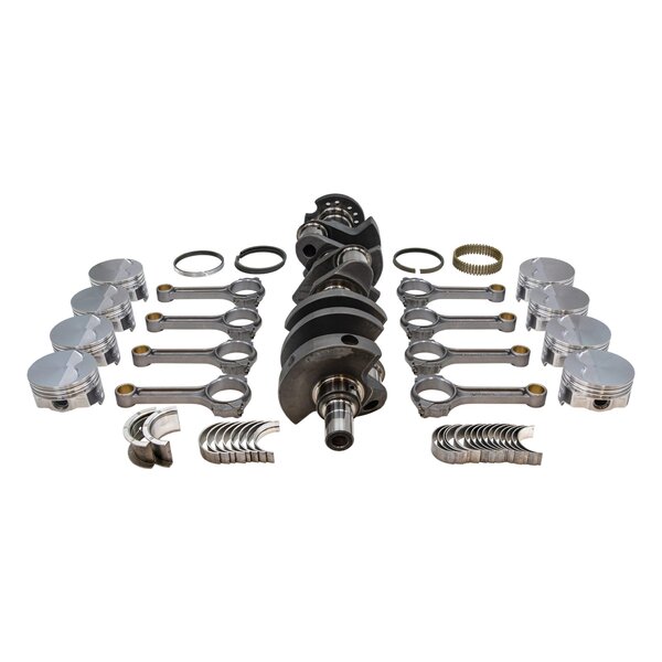

Back in post 51 I alluded to having some trouble with my "new to me" 340 and learned it needed a line hone. Well the machine shop in Conroe tells me that my crankshaft is worn out. I figured it was related to my two attempts at running it after my end cap was jury rigged. Not sure how it got past the shop in Florida though or what would have been so difficult to make the crank work. I made a quick attempt to see if an original crank was out there but in the heat of battle, I just ordered a forged kit with smaller pistons and told them to sleeve the block and get on with it. That was the day my 340 became a 372 due to the 3.58 stroke and 4.070 pistons. I went with a Comp XE275HL flat tappet cam.
1-48005BI-Chrysler-340-Rot-Assy-4340-Forged-Std-Wt-ProSeries-scaled.jpg the SCAT 1-48005BI kit showed up right away, the cam took quite a bit longer. One of those sourcing casualties at the height of the pandemic they tell me...

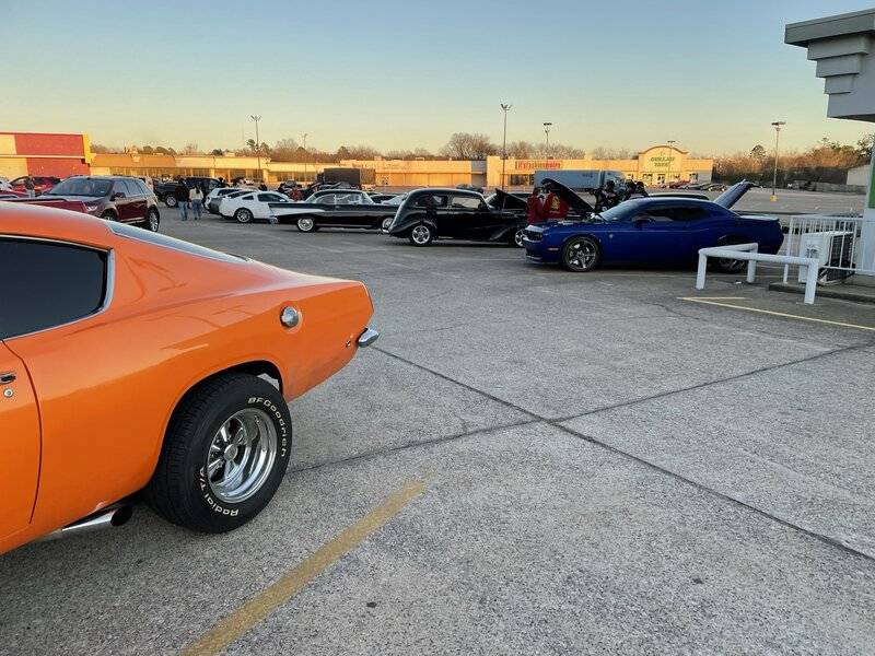

Park near a Camaro or mustang and 80% of people will look right past it.
Nearly 200 cars at our local show last weekend and there might have been 4 mopars between '65-'75. I will just have to get mine cleaned up and presentable next year I reckon! Better yet I may have to start some sort of cruise night for street hardened machines. You don't see many camaros or mustangs on the road any more. Now I say that and think, when was the last time you saw one of these in their native habitat?...

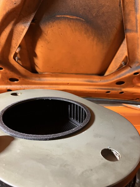

Used a fistfull of the kid's playdough (stuff he left out or mixed the colors all up) to squish between the hood and a board I placed on top of the carburetor. The Edelbrock air gap had things resting a little high in there. The results showed that i needed less spacer under the carb and some air filter base modifications.

The air filter base mods to clear the carb I spoke of. By the looks of the crud on the hood, it’s still tight in there.

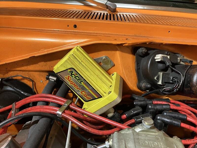

I had to replace my tachometer early in 2021. While I was in the dash I updated my oil pressure line to the copper pipe. I got it online and some (all) of the fittings were missing so they just gave me another set?! Hence the extra tubing. I also went with the only plastic old school coil I know to keep it from retaining so much heat.

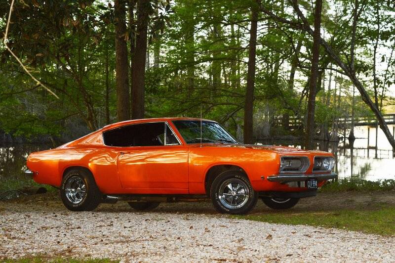

Damn! I love the color of your car !! Post more photos!!! On my phone, it looks like flames are about to burst out. Keep on moparing!
Appreciate that! The trick there is help from a diffused and setting sun. You can see the shadow of a big cypress cast over the rear wheel well. So the sun is hitting it dead sideways with lots of strange shadows. Any other time all ya see is scratches, chips, and a run or two :rolleyes:. A dozen years ago it was rare but now most manufacturers have a single step orange pearl.

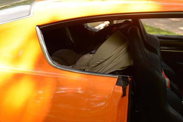

tandem baby seats. I ended up removing the back seat and mounting them to the floor at some point. We had another baby in May '21 and I drove them to daycare like this for more than a year.

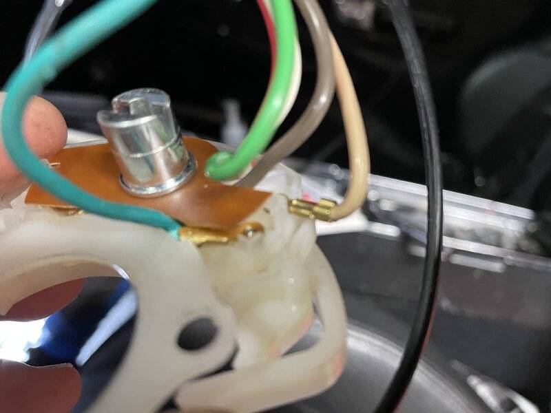

back to that turn signal switch- parts and a puller came in during the week. All going ok until I tried to sneak the wires back down the column. I found a speed bump in the wiring trough. Someone must have bent it "out of the way" at some point.
Finally fixed that wonky horn.
