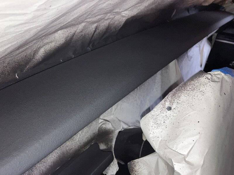

Finally, while buttoning the dash back up I had an epiphany for my crummy dash pad:
Painted original burgundy pad with bulls eye that predates me. I sanded the high spots off, filled the cracks with shoe goo, masked up the interior and shot it all down with undercoat!
Some of these repairs are “temporary” right? It beats staring at that spot I’ve had since 2011 anymore.
What d’ya think?

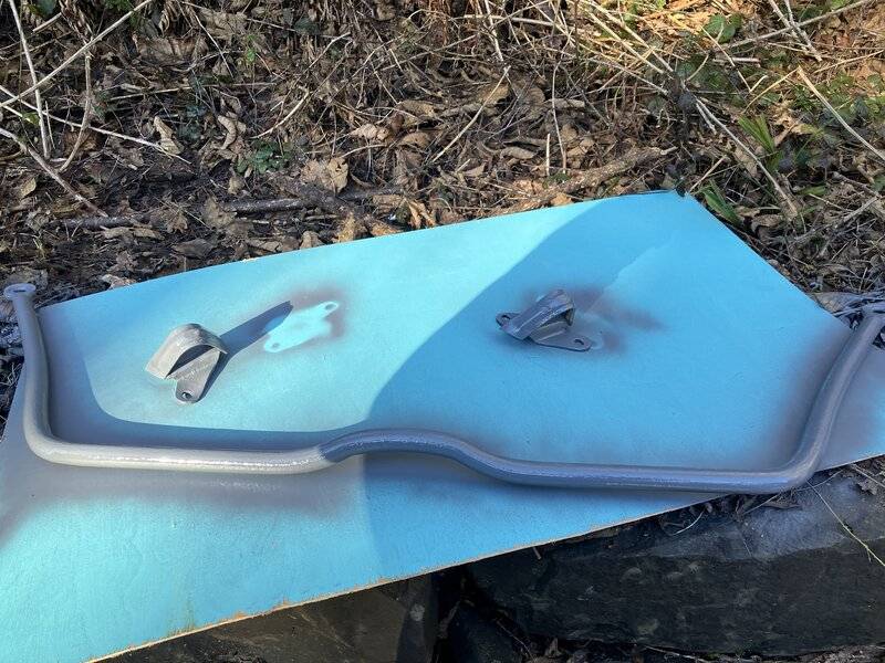

Front sway bar out and clean. Those old bushings were a mess! The car handles well with what I suspect is an original part. Maroon overspray in places! So I don’t see replacing it at this time. I’m prolly going to get the new ones in before the final round of paint.

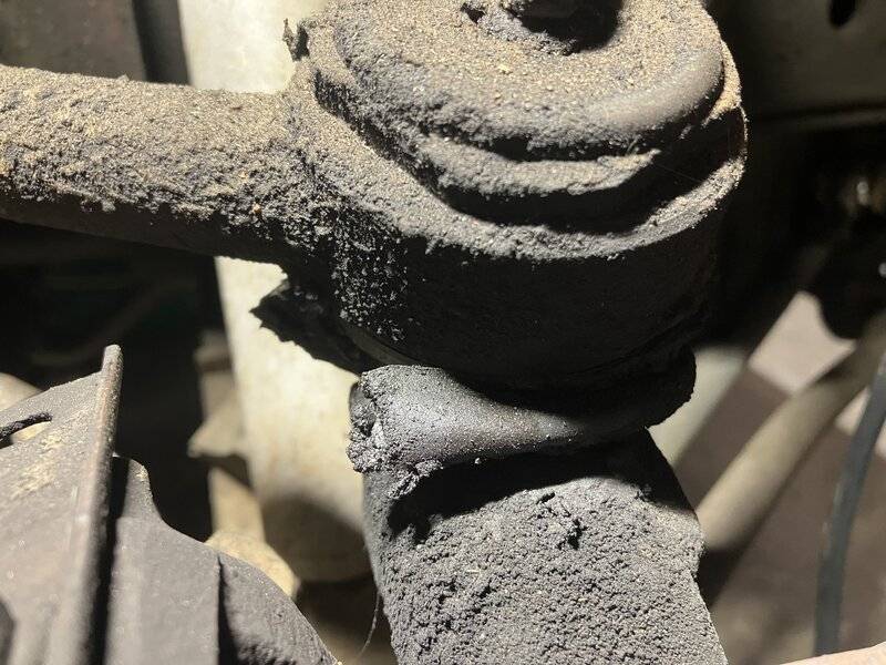

I've ordered a pickle fork to pry the upper ball joint out of the arm so I can replace the dust boots. I have found a recommendation for the Energy Suspension 5.13102G boots. but that is from a 10 year old thread. Thats about the time when everyone was complaining about how poorly boots seemed to fit just about any tubular UCA. Anybody have a more recent experience with any other boot? Let me know!! Oh and I can't figure out how that C-3711 tool is supposed to work exactly. the manual says jack up the LCA, which I understand helps line the lower ball joint stud up with the upper stud. But then I don't get the washer recommendation to protect the threads. Does this tool screw onto the upper threads and push against the lower stud? and where exactly am I smacking the steering knuckle with a dead blow hammer??? Thanks in advance!

hit the knuckle where the taper of the joint goes through, same as you would removing a track rod end end. i wouldn't use a pickle fork if the ball joint were to be reused again for risk of 'loosening' the joint, just my preference.
neil.
neil.
Heavy hammer hit knuckle hard it shocks the joints they pop right apart. Pickle forks is the slow hard way to do it.
