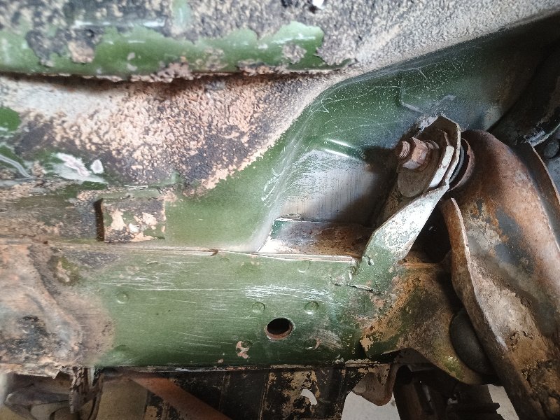

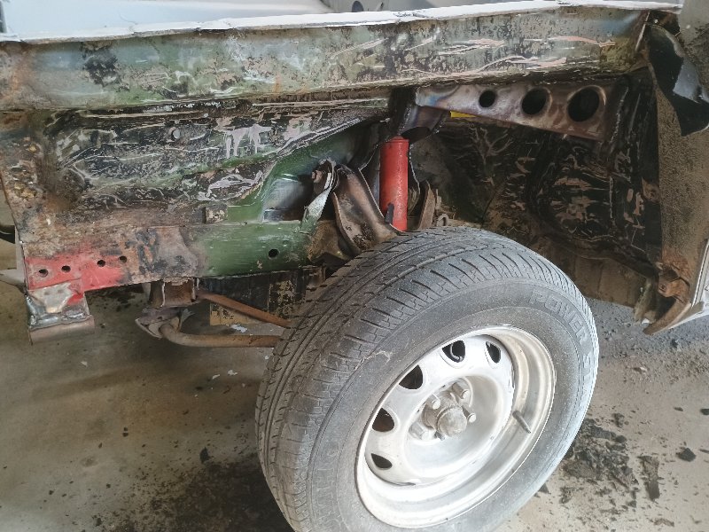

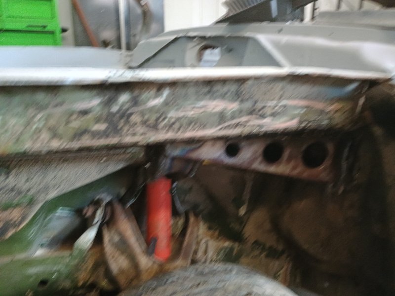

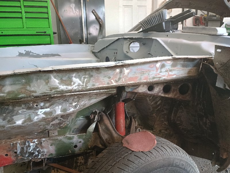

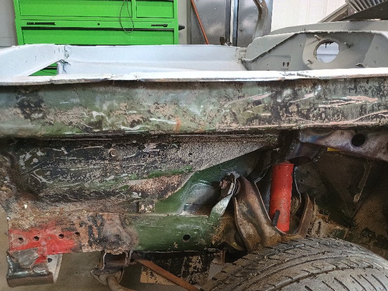

Dropped the K-member the other day. I plan on cleaning up the rest of the doghouse area over the next couple of days and hopefully shoot some color in the engine compartment and inner fenders over the weekend. Might also redo some of the welding on inner fender bracing.
