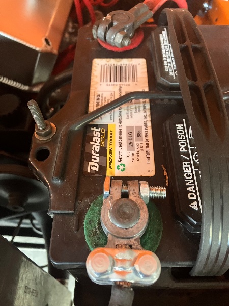

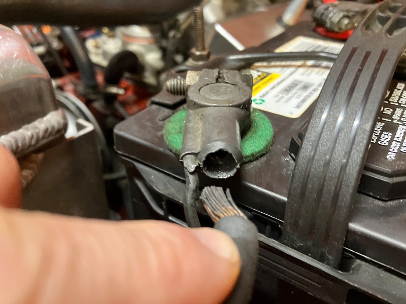

In other news; it died a couple times while running errands. Turn the key, get a tiny tick, then nothing! Wiggle wires around the battery, starter solenoid, regulator, and ballast and it would start right up!? I bought a new solenoid cuz it has been along time- like I’ve never changed it. Today I decide to disconnect the battery for now since it had been a little flaky for awhile. Don’t want to burn the house down or anything. AND VOILA my issue presents itself…
I had a terminal in the trunk since I spotting a crack in the positive terminal some time ago. I kinda arc’d it and went on my way. I know, I have hack tendencies. Notice that I don’t offer much help on the technical threads. I just post junk now and then & drive the wheels off of mine!

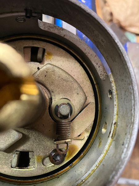

I took the distributor out again and swapped the heavy spring for a second lite one. Also closed up the slots a bit more.
So I’m thinking about letting the vacuum advance come in pretty early. I use ported vacuum though and I noticed that the new spring doesn’t have that oval loop in it. That stiff spring seemed to let the mechanical open a wee bit on the one lite spring by not coming into play in the beginning.?? All that to say I wonder if I’ll be getting much advance at all at idle unless I physically set it higher. So closed the slots up a bit to limit the top end.
the curve in my head looks like maybe 16* initially. I think my VA is 6 more in around 1700. (I’m at max cruising vac around 2300) then mechanical starting in the low 2000’s and all in before 3200. About where my converter flashes. Am I on crack?

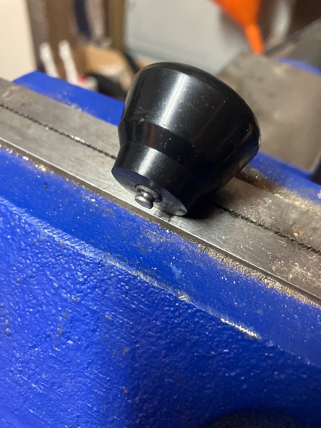

Tonight’s episode of how to not fix it right, I attempt to get the handle back on a broken window crank:
First thing I planed the burrs off the handle and cut the rubber back a little to allow more of the shank to be exposed.
Then drill the hole out to 15/64” to accommodate the shank.
Then I procured a couple e clips and snapped them on the shank.
Field test…
Should be fine until the next swap meet when I can pick up another one!
Until next time something breaks; cheers
